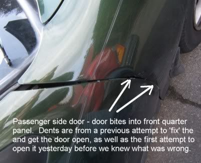

It appears the door is no longer centered on the pins correctly.
Here are some images to clarify things. Has anyone seen this sort of problem? What's going on here, so I know what to do? Most important, how do I realign the door, even temporarily, so that I can get it open to work on the hinge pins without destroying the front quarter panel?
Again, the passenger side front door latches properly and does not appear to drop when you open it.

hey. will the door open at all? if it will even a little bit jack the door up to try to adjust is back somewhat. honestly though if that doesnt work you may have to remove the fender and then do it. from the pics it looks like the hinge pin bushings are bad. you can buy bushings and pins for a few bucks at oriellys. and can adjust it properly using the gm certified tool they have it at any gm body shop . if you cant open it at all id pull the fender its the easiest way i can think of.
