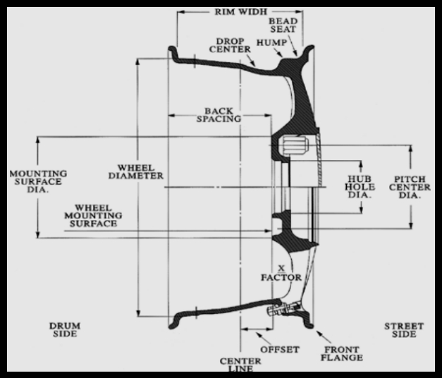

Default BOLT PATTERN & RIM DIMENSIONS---S10/Blazer
Rim- dia.15 x wid.7
Bolt Patt.- 5 lug x 4.75"
Back Spacing- 4wd: 6" 2wd: 5.5"

I own a 1999 s-10 blazer and have been searching around for some new wheels & tires but want to make sure that i have the right bolt pattern. im looking to eventually lift my s10 and get a bigger/wider wheel and tire and kinda wondering what size rims/tires i should get as well...
different forums say alot of different things that the right pattern is 5x4.75". so far this is what ive gone with until i found 5x(120.65mm) and not sure if thats the same thing as 4.75".
thank you anyone who can help
