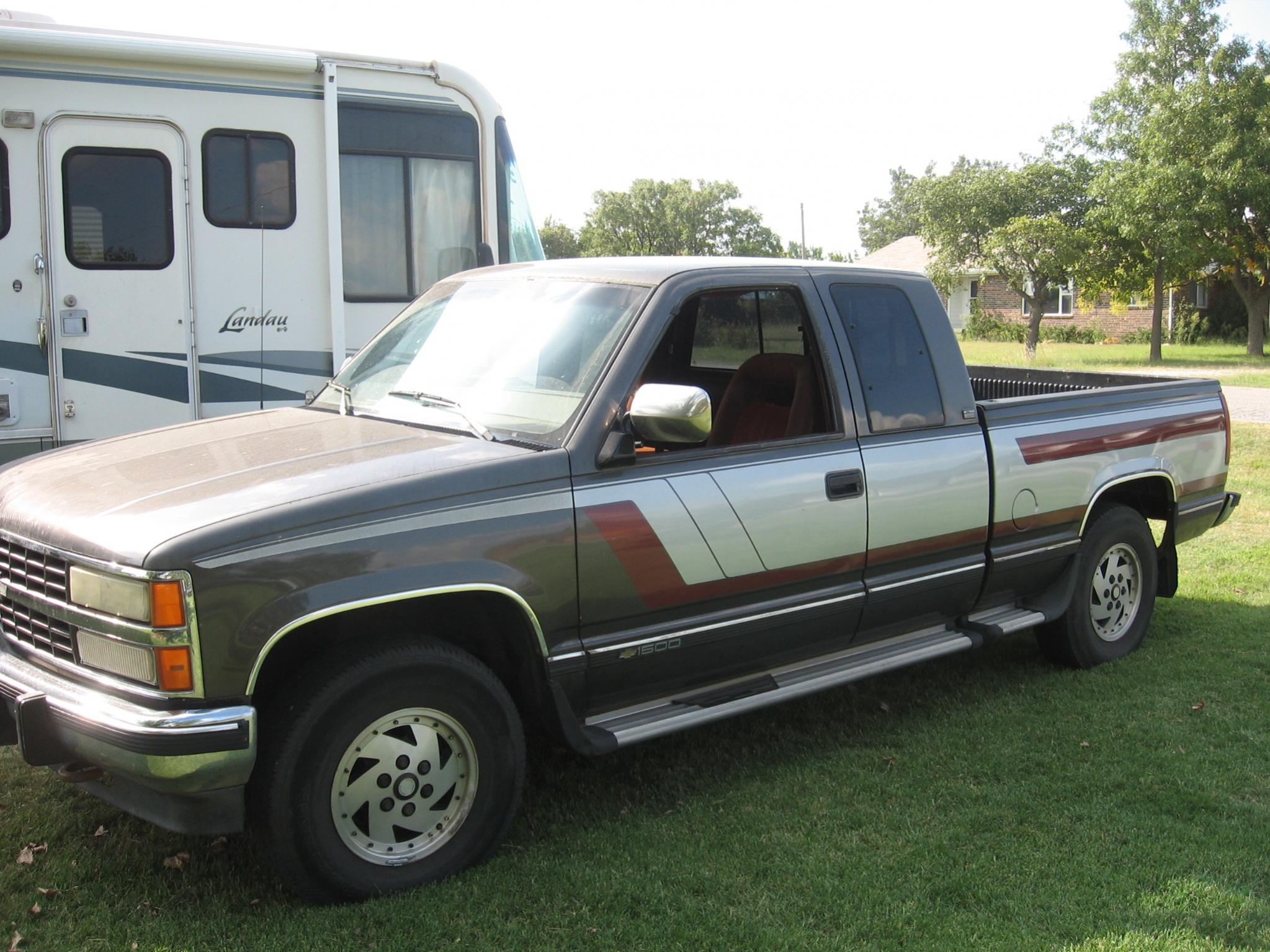

I have a 91 chevy k1500 5.7l tbi auto 4x4... I bought this truck a couple of months ago with 167,000 miles on it and it ran fine... Now it sputters and seems like its either flooding its self out or missing while driving... If the map sensor is pluged in it will not idle or run properly while driving. If i unplug it it sometimes idles fine but runs like it missing while driving it... I have replaced the plugs, wires, cap, and rotor thinking this will fix the problem. Tested the tps, map sensor, and egr valve and all of the work properly and replaced them thinking that maybe it was human error but still the same problem. Replace the coolant temp. Switch hoping that it was sticking open or closed but that didn,t work either. Pulled the catalytic converter off thinking that maybe it was starting to clog really bad but nothing... Im really confused and thinking about sending it to a shop but don't want to pay the money... Kind of broke... Any ideas or suggestions of any kind would be appreciated... Thank you...
