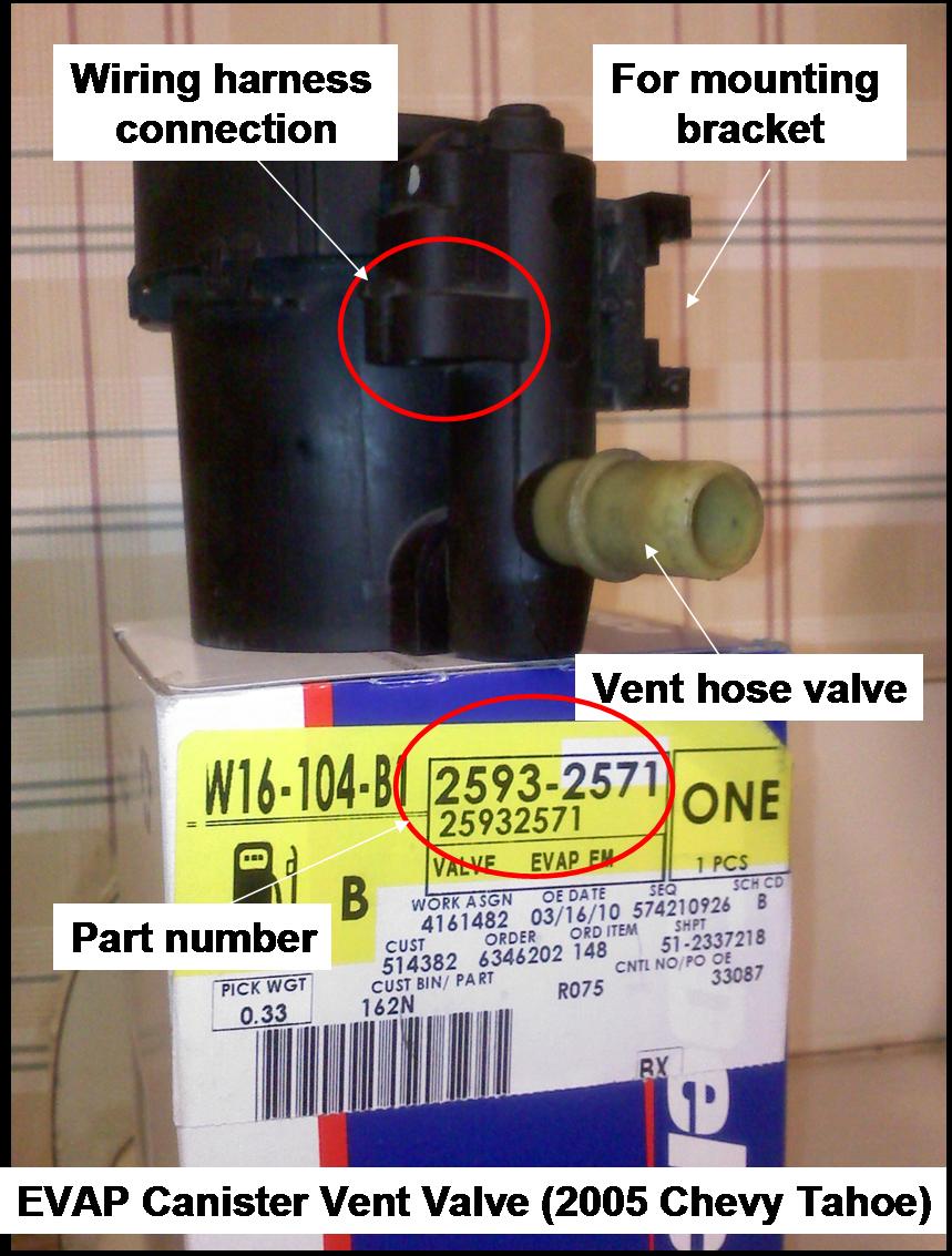

If you have a Tahoe, it will likely be attached ot the EVAP canister near your gas tank. I have attached a few images that should help you locate it:
EVAP Canister Vent Valve (2005 Chevy Tahoe)
http://www.chevroletforum.com/forum/...7&d=1273543919
Service Manual's description of EVAP System
http://www.chevroletforum.com/forum/...8&d=1273543989
http://www.chevroletforum.com/forum/...0&d=1273544034
Hope this helps!!
