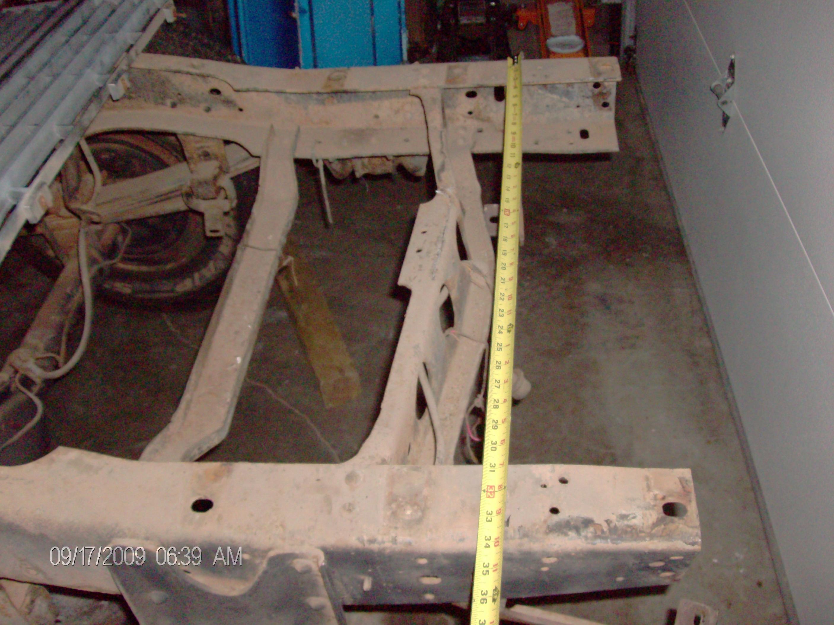

From the inside of the left frame rail to the inside of the right frame rail I got 28"
Old Sep 17, 2009 | 8:40 AM
myotherchevyisablazer's Avatar
Joined: Jun 2009
Posts: 518
From: northern california
pete the measurements need to be from outside to outside........
red

Thanks for the pic with the measurement man...that will come in handy in the spring when I start the tear down for some major body work. Sadly it's almost time to get the tarp out and store her away for the winter.
