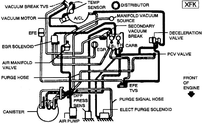

Ok, there are a few different ones depending on where it was sold, here is the california emissions one.

Jeez that looks complicated. Grew up in Texas, never had to worry about this smog crap til I moved to California.

Just take it one part & line at a time, it just looks complex.
