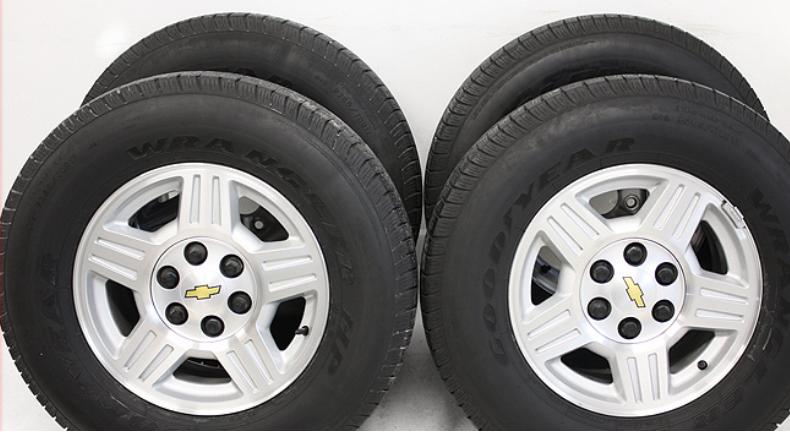

I have the 2007 Tahoe 17" 5-spoke LS version rims (spokes have two grooves on each spoke going from center outward to edge of rim - pic with the tires) with TPMS sensors. I just picked up some 2007 Z71 Silverado 5 spokes with no groves on spokes(pic without the tires). Tires are way better on the z71 rim....offroad look.
Before I sell the wheels with TPMS sensors, Can I move the sensors to the Z71 rims? I don't think any 2007 Silverados (classic version) came with TPMS? The rims also came on the 2006 Tahoes.
How much should I expect to pay a shop to move the sensors from one rim to another(both have tires on)?
Also, how can I turn off the dashboard light until I get the sensors moved to the other rims? Thanks for all the help.

u can remove gthem and install to any other rims. You should remember position ( front left, front right, rear right and rear left) unless u wanna relearn them. It's easy to do.
All u need is new TPMS valve kit. Do not replace them without valve kit !!!

The light would stay on because the pressure is zero. It would think you have 4 flat tires.

Thanks for the info. I was gonna remove the sensors and sell the oem wheels but i'll just hold on to the oem wheels and till i move the sensors over when i get new tires. I'm not sure if the sensors will work in the older rims as ebay shows different types of sensors for the same years.
I'm guessing the sensors are screwed into the valve stem area but some other sensors have screw that bolts into the rim besides the valve stem screw.

sensors will work in older rims. Problem is, that older sensor could not work in newest cars. If u going to use same sensors, just mark them and install them in same wheel (FL, FR, RR, RL). Than u don't have to reprogram them.

Dorman makes aftermarket sensors not the originals. You do not need a valve kit . I took my sensors out of my factory 17" wheels and put the into my aftermarket 20" wheels a year and a half ago without buying anything. At work we switch tire sensor into new wheels often without a problem
