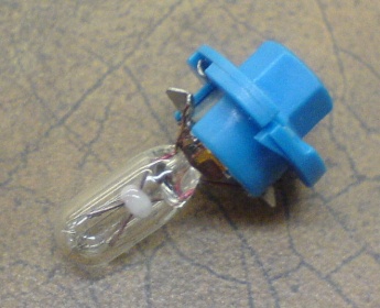

I have this same problem. I contacted the dealer and they said the bulbs behind the gauges are not replaceable and are not sold and they only will replace the whole gauge set. I didn't believe them and so I pulled the gauges out and was able to pull the pulls out but the dealer was right. I haven't seen a bulb like this before and neither has the part stores in town. My dad mentioned the best bet is to go to a wrecking yard and find a 2005-2006 chevy/gmc with a gauge cluster and see if I can pull the bulbs out and buy them there.
Does any one else have any suggestions? I actually have pictures of the bulb but now where I am at now. Let me know if posting them will help.

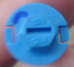

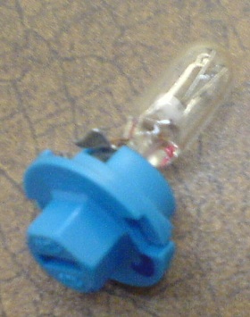

Here are the images I got from the light bulbs, sorry it took a while. The images were on an old cell phone that I can't use any more and it took a little to find all the right cables. I have the originals in higher resolution plus 2 or 3 more files. On the blue plastic piece it said it is a 12V 12 W lightbulb and it also said alba.

I had my bulbs repalced by a local mechanic who said you could solder in new bulbs to the blue plastic base if you wanted to but it was a lot of intricate work....he recommended going to the scrap yard and collecting as many as you can ....so thats what I did...lol. The scrap yard didnt even charge me for them.

Well it seems that chevrolet wants to replace the whole cluster because they dont sell just the bulbs.
Hers what i did, i went to an electronic store, in ottawa ( gervais electronics ) and he gave me 3 light bulbs for 4 $.
You take a small pointy objet, insert into the base of the bulb slowly the bulb should come out, then using wire cutters simply just cut the 2 small copper wires.
the bulb wire from the store are long enough all i did was wrap the wires arounf the silver pins, no solder required, put the bulbs back in and voila it works,
you can also go to canadian tire, match the light bulb and do the same thing wrap around..

yes it is quite easy withing reach in about ten minutes. here are the steps to take too change your bulbs without changing the whole cluster..
1- remove 4 exagon screws from instrument panel
2- slowly gasp one end of the plastic casing to unclip the black plastic casing from the dasboard,
3- remove electrical wire, its a clip on youll see.
4- the whole console should be in your hands now, their are about 6 plastic clip on that secure the base, slowly, gentle pry them open
5- remove the bulb by turning it, remove it, keep the palstic blue casing , slowly pry out the old bulb, the new one take the 2 wires and wrap around silver contacts, re-assemble,
the rest is the reverse, should take no more than 10 minute and canandian tire bulbs are about 5$ for 2 hope this works let me know
