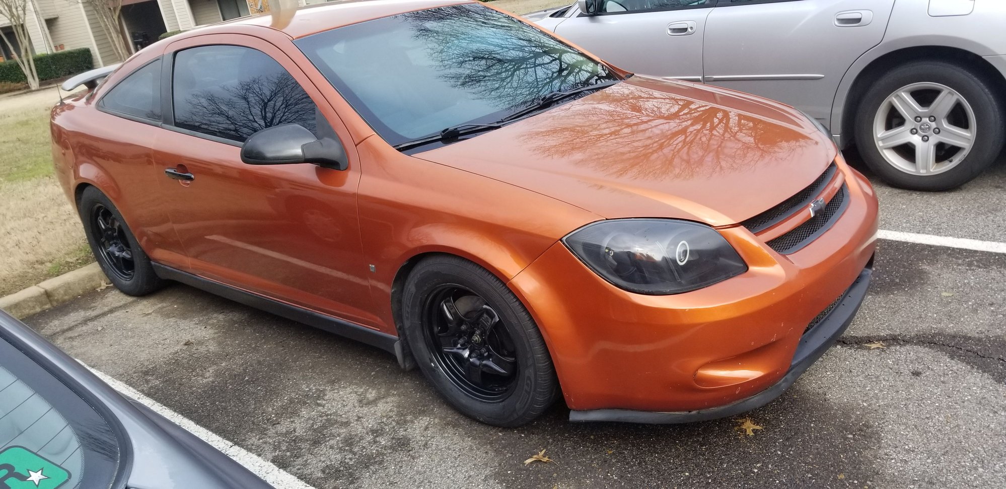

Hi everyone, I recently did a rear axle swap on my 2006 chevy cobalt ls from an 2006 ss with the rear disc brakes and now I'm having an issue. The brakes are very squishy and you have to slam them almost to the floor to engage them. I replaced the master cylinder, bled the brakes twice and adjusted the rear and front calipers. My car doesn't have abs. I'm confused to as of what is going on, so any help would be greatly appreciated!
