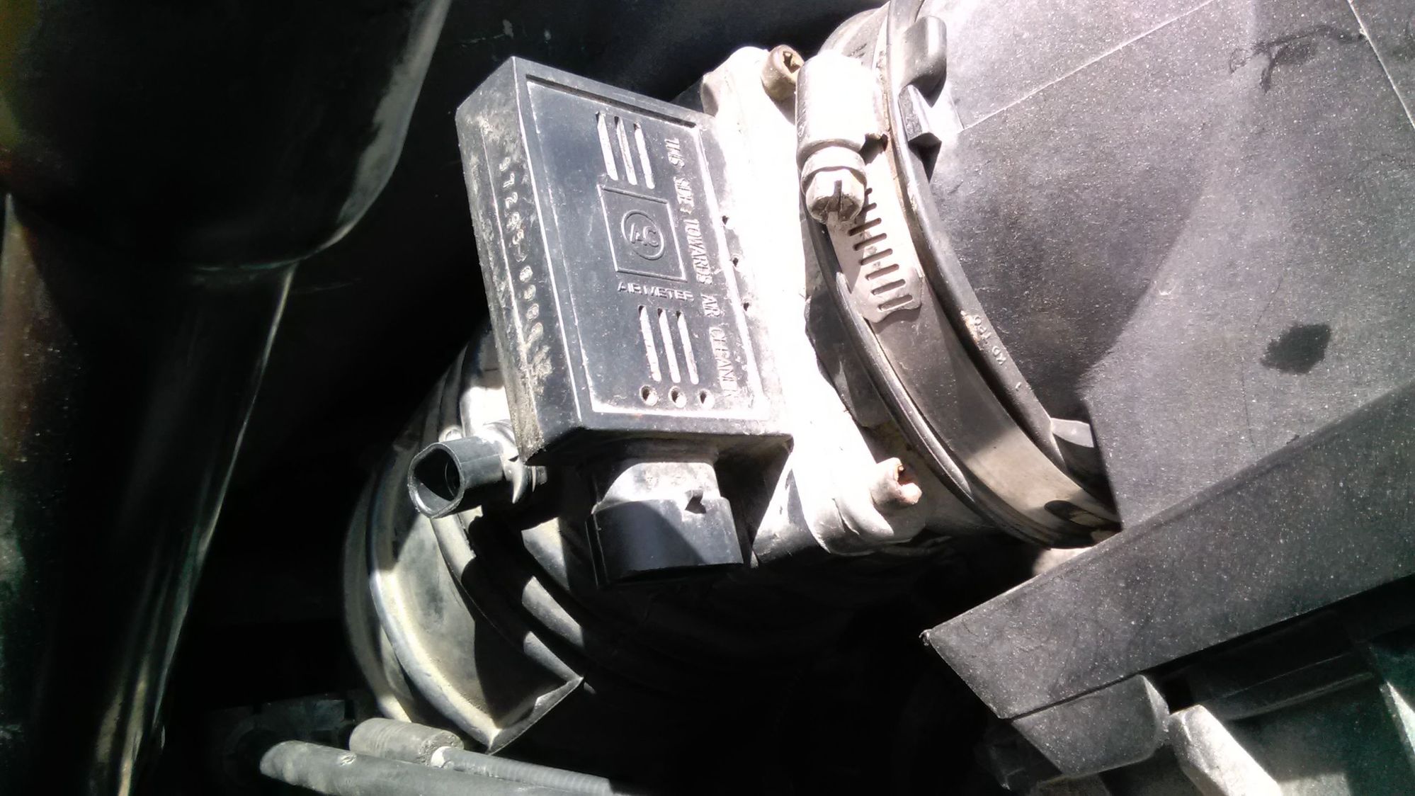

Greetings:
I have a 96 G10; it is a relatively recent purchase. I was looking at the van for what I suspected was a vacuum leak when I noticed that my MAF sensor appeared to be missing its connector. While it is quite clear that there needs to be a connector going to the MAF sensor, I am less positive about where the "other end" of the connector is supposed to go. I do notice what appears to be an absent connection on the air intake tube (very close to where the MAF connector goes)/ I suspect this is where the other end plugs into, but I am not certain. The van is a 5.0.
Missing connector.
Could anyone confirm or am I missing two distinct connectors? Also, where might be a good place to purchase just the connector?
Thanks.

Yes, you are missing two connectors, they should be part of the engine harness. That part of the harness should be laying on top of the motor, do you see any cut wires?

Pull the maf itself, there are (as posted) two connectors. It could be lying underneath it.
