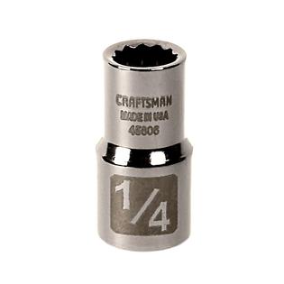

I know this is an old thread but just in case someone is searching for this info
I linked in here from a google pics search on torx sockets. The socket your trying to find is actually a 12 point 1/4 inch standard socket.
I changed my standard Sierra headlights with some Denali projector lens type and they needed adj.

12 point socket works and an allen wrench works. My coworkers get mad because i use a ratcheting t handle allen to ajust headlights
