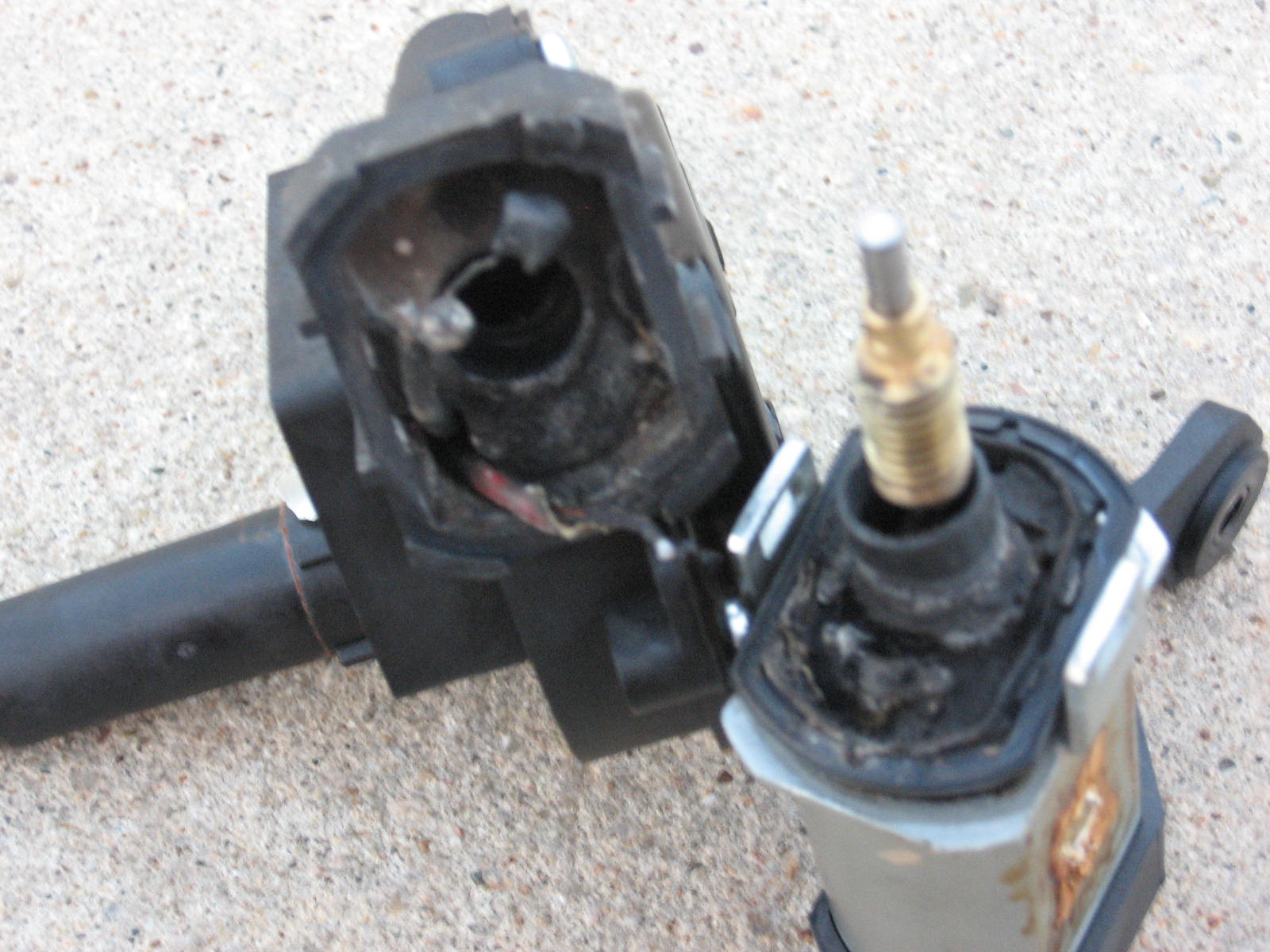

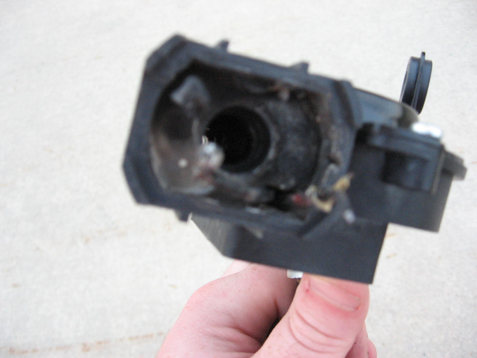

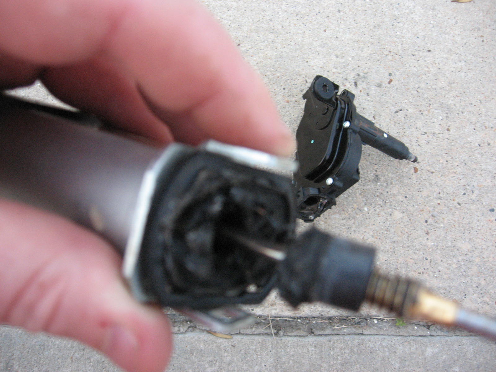

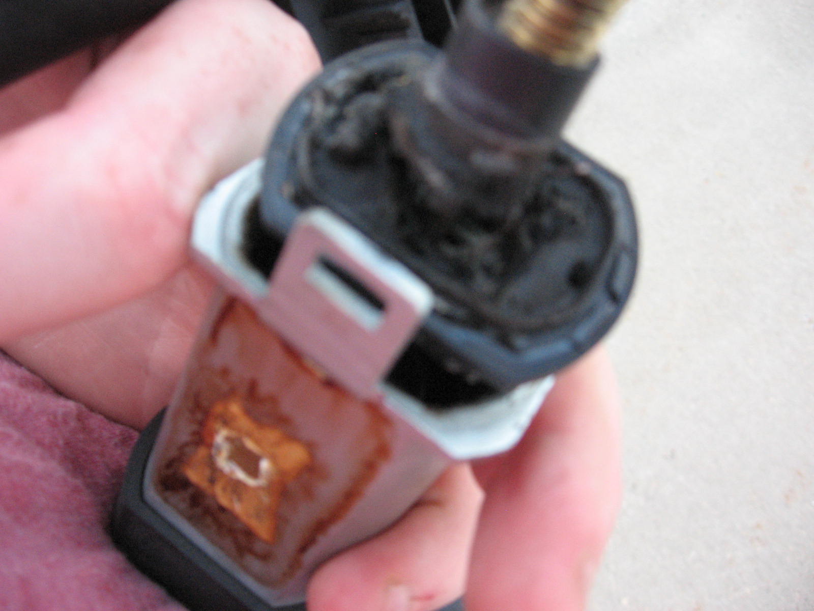

So I finally got around to looking at this earlier tonight. The motor is definitely what's bad. It got really hot at some point and it melted the insides. I've posted some pics below. A new motor (AC DELCO/GM p/n 19329491) from RockAuto is about $100.
Some pics of the melted insides...
2007 Equinox rear wiper motor not working...rear wiper arm won't come off-melt1.jpg2007 Equinox rear wiper motor not working...rear wiper arm won't come off-melt2.jpg
2007 Equinox rear wiper motor not working...rear wiper arm won't come off-melt3.jpg2007 Equinox rear wiper motor not working...rear wiper arm won't come off-melt4.jpg

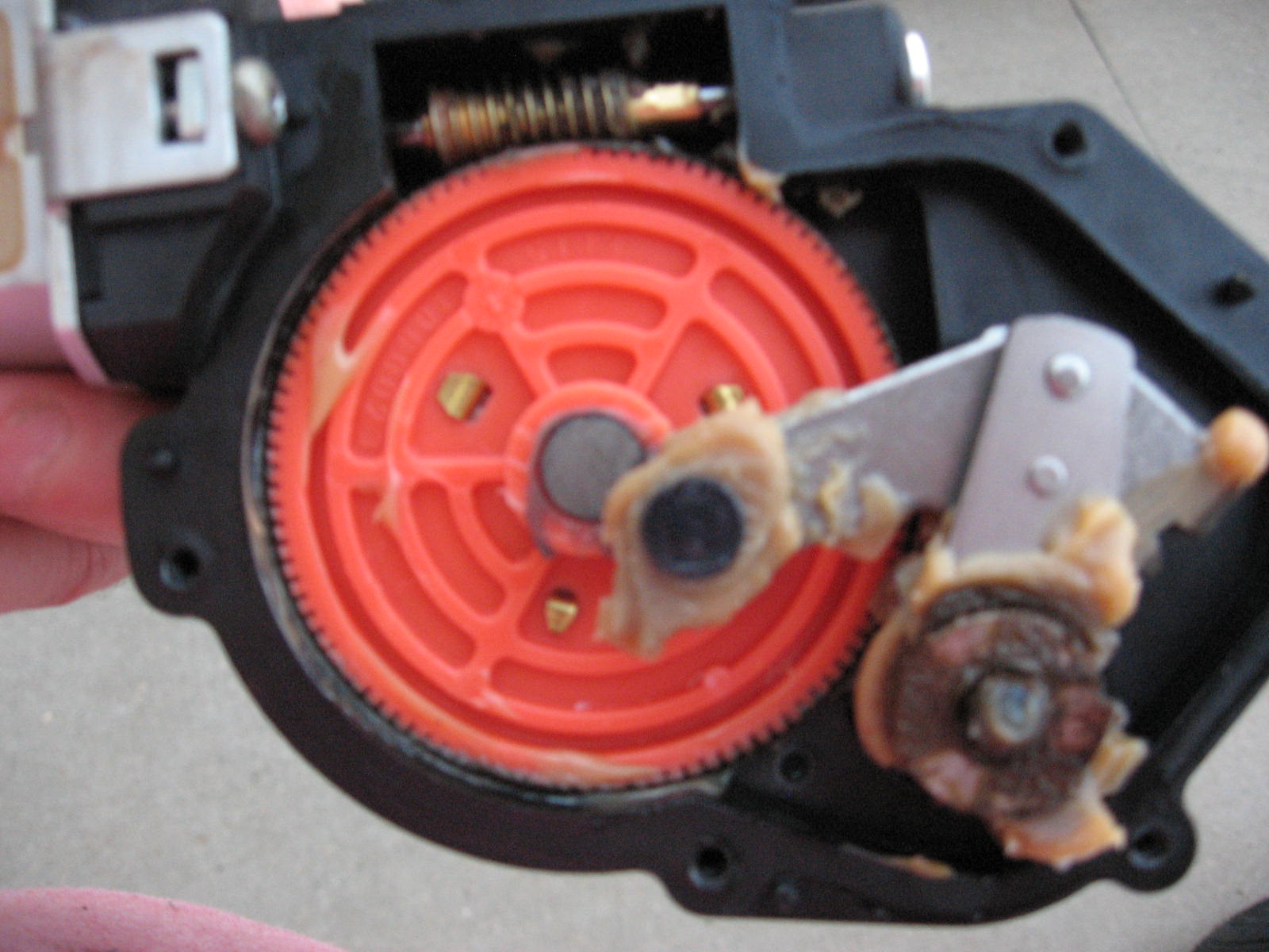

And one pic of the internal mechanism because I was curious...
2007 Equinox rear wiper motor not working...rear wiper arm won't come off-inside.jpg

So I finally got around to buying a new wiper motor and installing it before it got too cold out. It took me about 45 minutes. The problem is fixed. The rear wiper works better than it ever has. The wiper definitely moves a bit faster than it ever did with the old motor.
I'm hoping it doesn't burn up like the OEM motor. The new one supposedly has an improved design, but it looked just like the old one on the outside. As you can see in the pics in my previous post, the old motor was completely burned up and not in working order.

Where is this retaining nut you speak of? I am having some issues with my rear wiper, it doesnt move either. It seems that it was pretty rusted up on the gears of the mechanism, and also it popped out of the orange circular thing in you last pic. How do i get that post back into the orange thingy? Very novice car guy here, please help.
