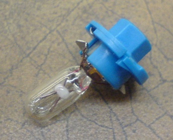

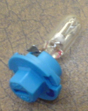

Here are the images I got from the light bulbs, sorry it took a while. The images were on an old cell phone that I can't use any more and it took a little to find all the right cables. I have the originals in higher resolution plus 2 or 3 more files. On the blue plastic piece it said it is a 12V 12 W lightbulb and it also said alba.

I had my bulbs repalced by a local mechanic who said you could solder in new bulbs to the blue plastic base if you wanted to but it was a lot of intricate work....he recommended going to the scrap yard and collecting as many as you can ....so thats what I did...lol. The scrap yard didnt even charge me for them.
Now I have to do the alternator voltage regulator fix to ensure my new bulbs dont blow!! My mechanic says the flickering headlights issue that most Uplander owners are having is the main reason the dash light bulbs are blown as they are the smallest and weakest link in the lighting of the van....

Well it seems that chevrolet wants to replace the whole cluster because they dont sell just the bulbs.
Hers what i did, i went to an electronic store, in ottawa ( gervais electronics ) and he gave me 3 light bulbs for 4 $.
You take a small pointy objet, insert into the base of the bulb slowly the bulb should come out, then using wire cutters simply just cut the 2 small copper wires.
the bulb wire from the store are long enough all i did was wrap the wires arounf the silver pins, no solder required, put the bulbs back in and voila it works,
you can also go to canadian tire, match the light bulb and do the same thing wrap around..
