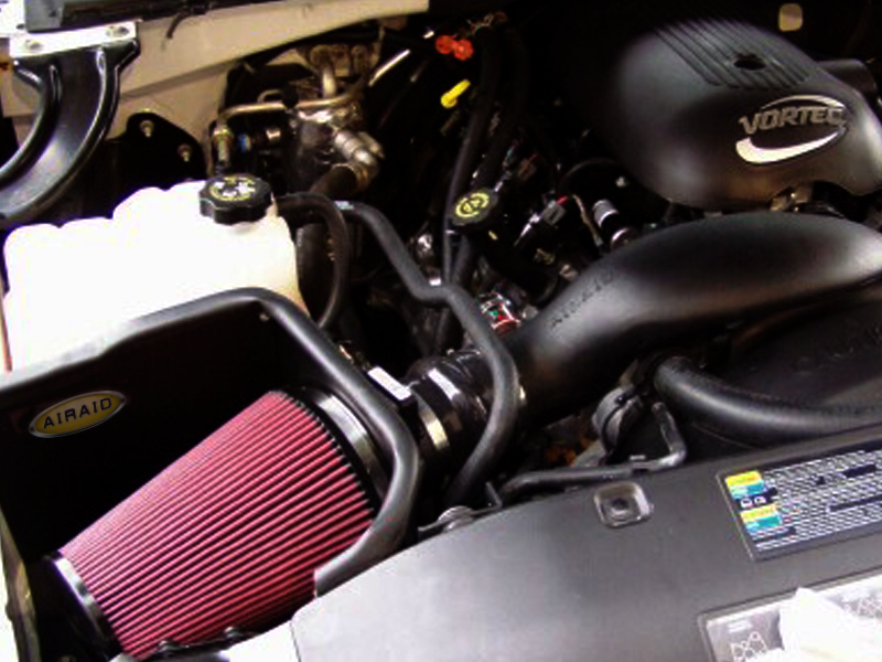

Does it have an aftermarket cold air intake kinda like this?
Attached Thumbnails Truck started hesitating while accelerating just now?-200-145-installed.jpg
