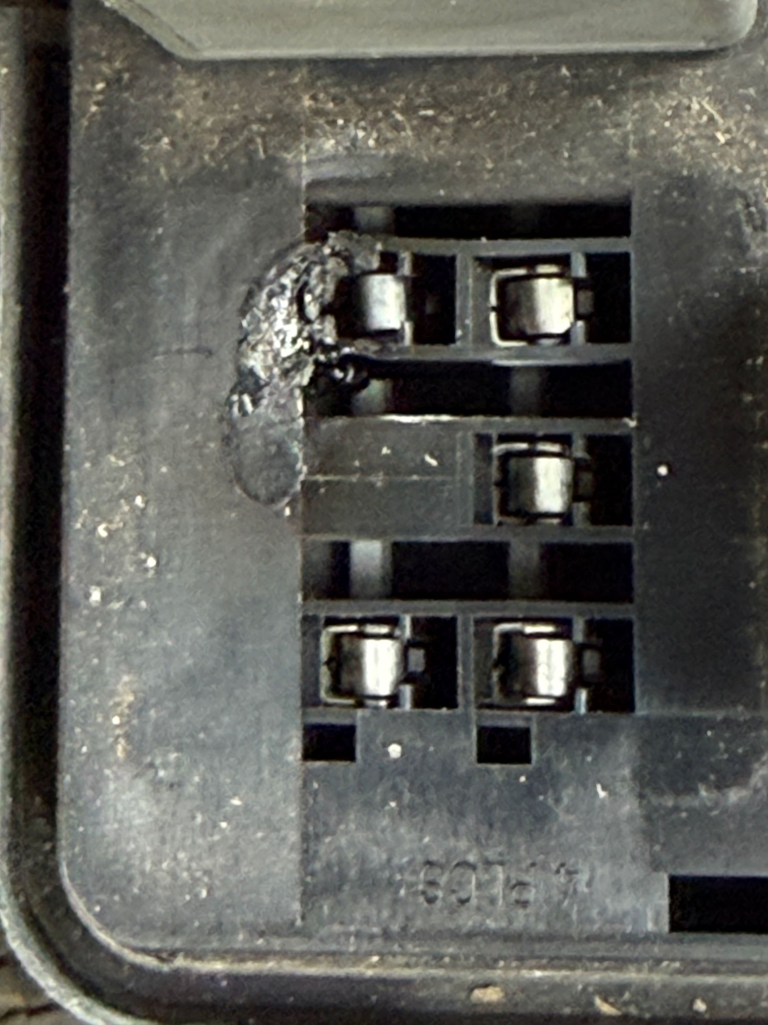

Well, I had just a few minutes to look at the situation on Saturday. There is most definitely no noise from the fuel pump when the key is turned to the run position, and normally, I know it should run for at least a couple of seconds to pressurize the fuel rail.
I popped the hood to check the relay, and found this. This is not the original relay, as it is not a grey OMRON like the rest of them, so I've apparently replaced this at some point in the past 30 years. Probably 20 or so years ago when I had an issue with the fuel pump wires shorting inside the gas tank (yes - inside the tank!).
This is the bottom of the relay - you can see that one pin has been pretty hot, and that might be dated to when the fuel pump cut out due to a short 20+ years ago... or it could be recent. Who knows?
And here you can see some matching "melt" damage in the fuse/relay box under the hood...
Unfortunatley, there are no other 5 pin relays under the hood to swap with this one - the others of similar size are all 4 pins. So I guess this issue will sit while I go ahead and order a relay AND a fuel pump from RockAuto. If I am lucky, the relay will be it. And if I am not lucky, I'll be unbolting and disconnecting a lot of stuff under the bed, and taking off the tailgate, tail lights, tool box, etc, so that I can get my son and son in law to drop by one day and help me lift and walk the bed off the truck and set it in the garage.
I am lucky that I live in Alabama. If I lived farther north all the bed bolts would be rusted up and likely not removable. As it stands, I did this once, 20 years ago, which I was 40 versus 60, and do not look forward to doing it again.

Well, sometimes the simple fix is the fix. I spent $200 at Rockauto on a new Delphi fuel pump assembly, a WIX fuel filter (needs to be changed anyway) and a GM wiring harness end and a GM fuel pump relay.
The low hanging fruit was the relay, so I popped that in not expecting much, and much to my surprise, the truck fired right up!
