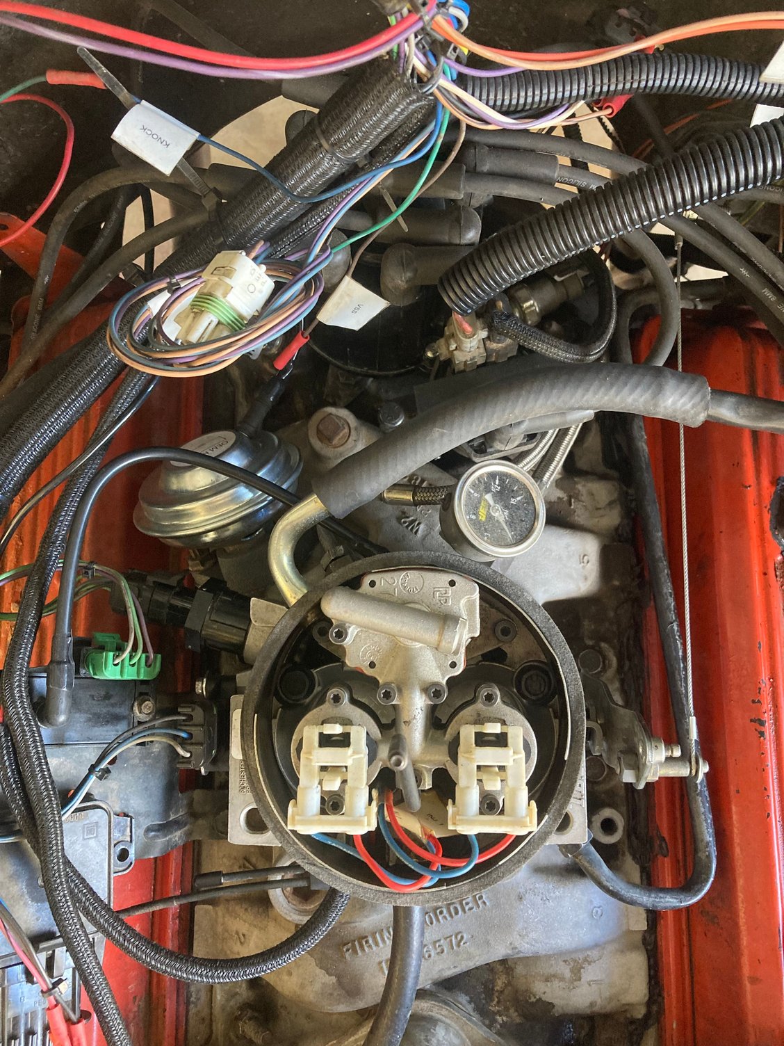

Here are some engine photos.

I’m speechless….
I mean the level of disappointment is simply inexplicable…………
There’s not nearly enough blaze orange on that engine!!!
I recommend verifying the MAP is receiving a 5 volt reference and has ground - it may be reading 0.98 at idle but if it’s receiving only 4.5 volts or less, the signal will be off.
As I stated before, the MAP and TPS share the same reference circuit, so compare the MAP to the TPS to verify the signal. They should match with no more than 0.1 volt difference. It should be there at key on and after starting.
The MAP orientation will not affect its signal as long as it’s a functional sensor and is receiving full manifold vacuum. You could mount it upside down on the firewall if you wanted. And really, why NOT?
If it’s receiving ported vacuum, it should be relocated.
Also, it occurred to me that you need to “reverse” the vacuum leak test. Plug all the vacuum ports again, only this time, attach the MAP sensor first. It’s possible (though unlikely) that the ECM didn’t respond to the vacuum leak until the MAP was hooked up. So by reversing the test, you’re verifying the problem with a different method.
