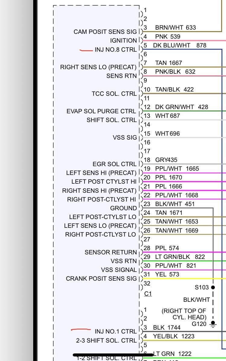

Have you checked for a pulse signal using a noid light at the injector connector?
Reading back through the thread, it sounds like the *assumption* that the ECM isn’t pulsing the injectors has been made, but no actual testing has been done to confirm that.
If the noid light doesn’t show a signal at the connector (make sure to check one injector on each side as the 12v power feeds split into 2 groups before the connector), back probe the same pins at the ECM and rig the noid light. If there’s a pulse signal while back probing, there’s a problem with the wiring harness. If no signal while back probing, I’d verify all the power and ground feeds to the ECM are good before continuing to chase and replace anything else.
Below are the individual circuit pin outs for the injectors at the ECM. Note that injector 8 is the only one on connector 1 and the rest are on connector 2.
