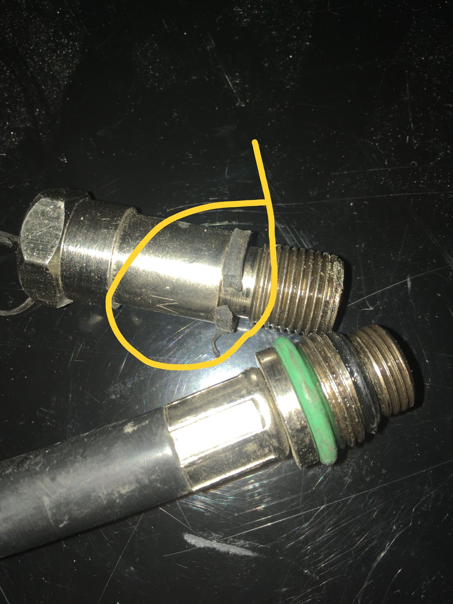

I started my compression testing on bank 2 and have concluded that my compression testing equipment and/or skills are lacking. Cylinder 2 held good at 180. Then I did cylinder 4 and it was a 120 dropping when I got around the front of the truck. I pulled the tester out and saw a blown o-ring on the extension. I bypassed the extension and no difference for cylinder 4. I then re did cylinder 2 without the extension and it was 170 dropping when I got around to the front of the truck. The tester seems ok with a button to relieve the pressure so I'm going to put a new o-ring on it. It's ancient so I'm not surprised the o-ring broke when I put a wrench on it. I suppose dropping pressure could mean blown rings cylinder 2 held at 180 so I'm going to assume it's the o-ring for now. Also, my friend Cassie the cat reminded me that I still have the original engine in the crate that came with the new engine and if I can get it running, I want to do a complete rebuild on that with the 400+ hp head work I've been reading about. Cheers
