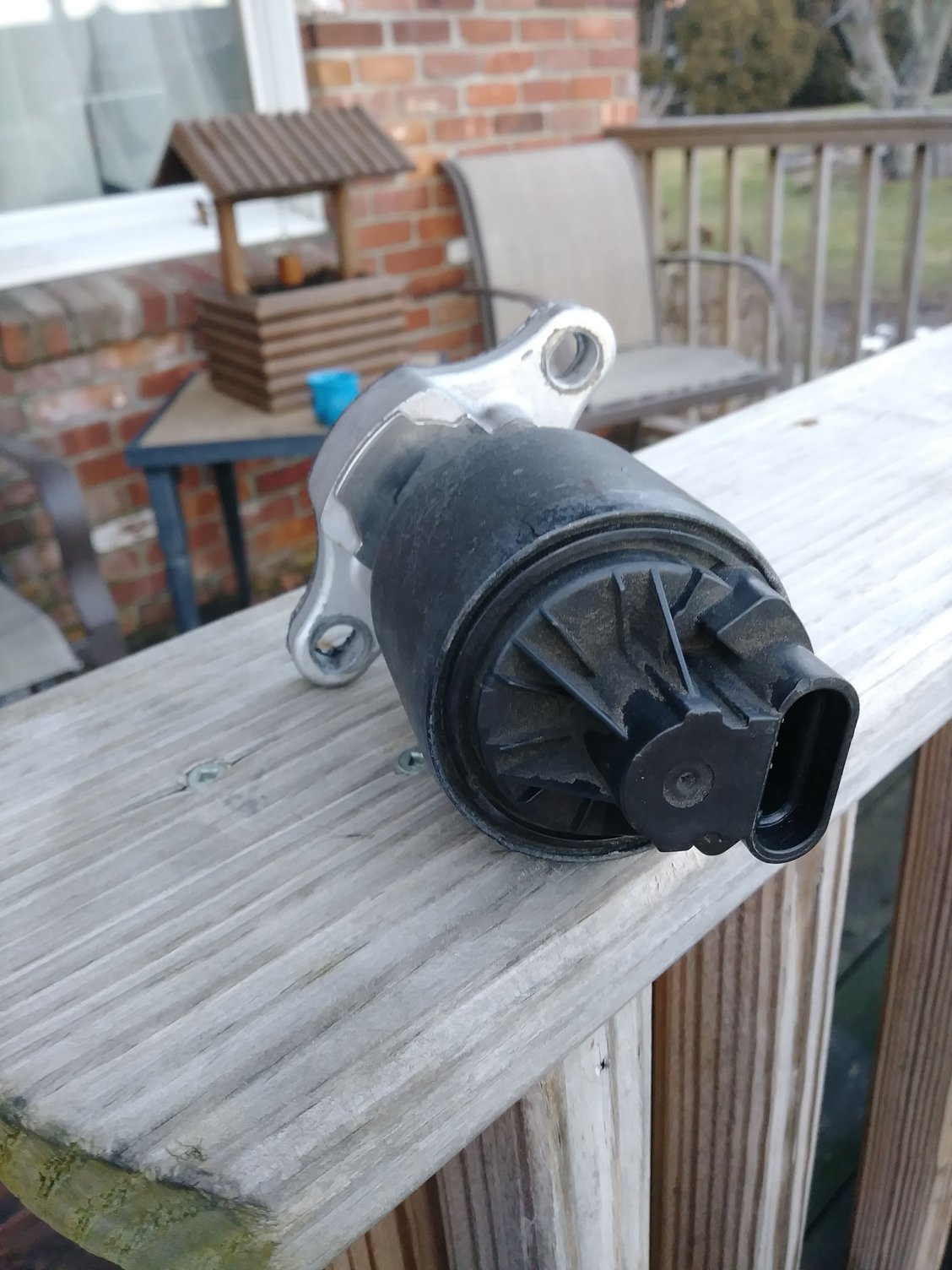

So, been a bit busy so I haven't been able to post anything. Managed to successfully pull out the EGR valve from my truck and visually inspect it (have pictures and I may post them incase anyone doesn't know what it is and has a similar issue). The EGR valve didn't have any carbon build up that I saw, and the gasket itself seems to be in good condition. I flipped the valve over and tested the valve stem manually. The stem sprung back out a without any hesistation.

Here are the pictures of my EGR valve. Side note: I decided to run a little experiment on the way to work today. I unplugged the EGR connector for my truck to see how it would idle on the way to work. Naturally, the RPM's were higher than normal and the check engine light remained. However, I noticed that the idle didn't improve.. if anything it got worse. So I'm thinking, and please correct me if I'm wrong, but I'm thinking that my EGR valve is stuck on open?
