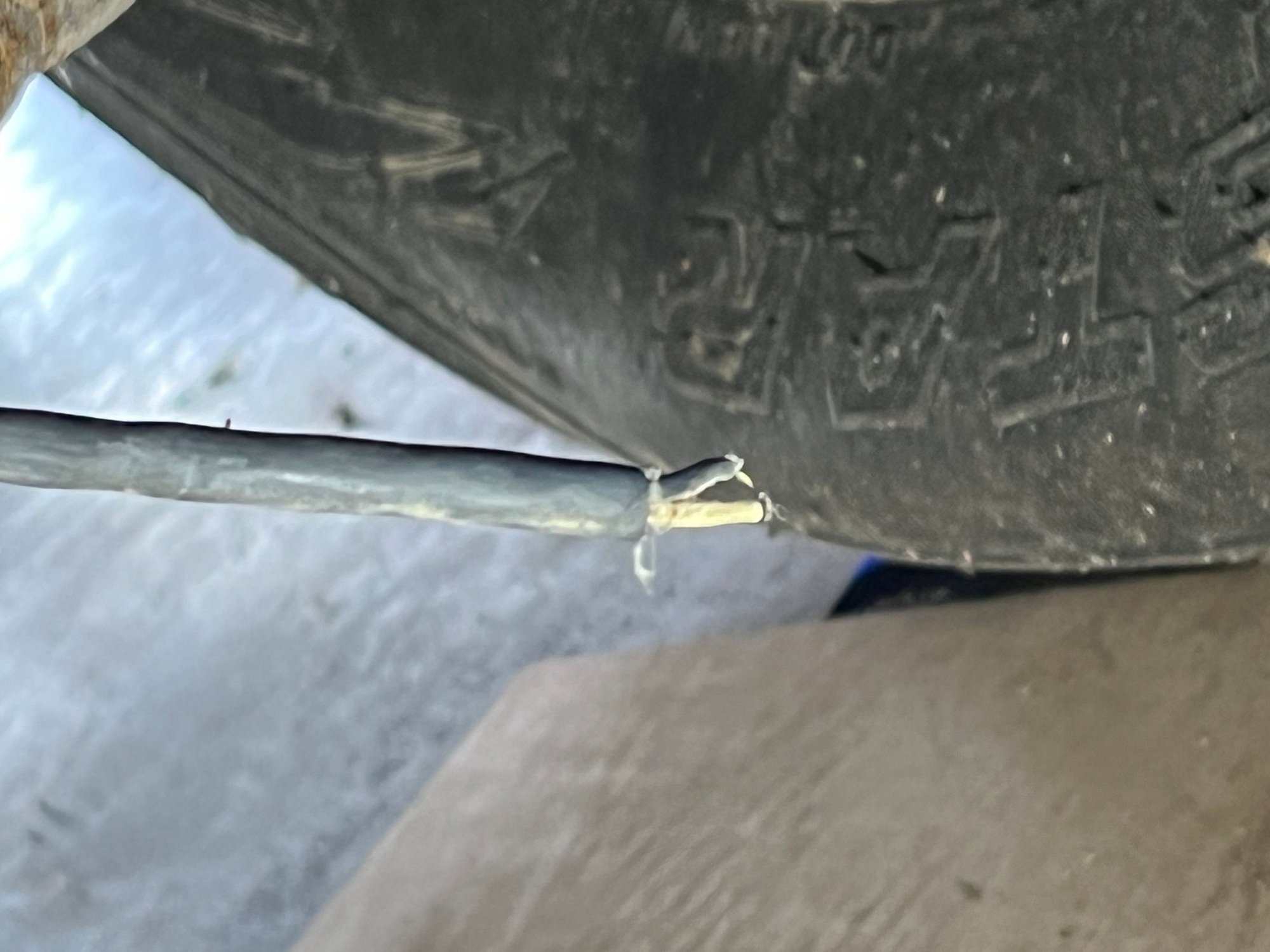

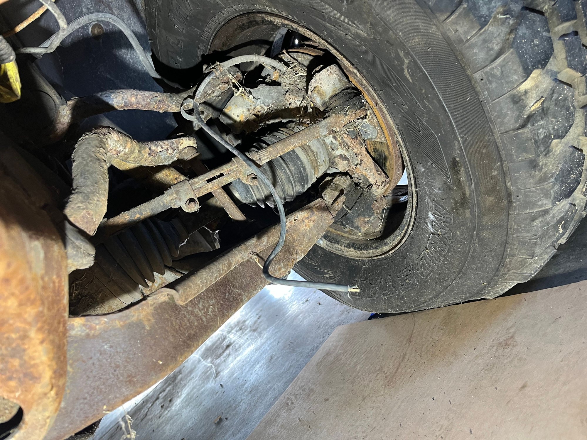

Found a black and white cable coming from the front driver side brake caliper, does anyone know what it goes to?

It is probably the wire to a wheel speed sensor - used by the ABS (Antilock braking system). I would trace the wires from the ABS module and see if you can find where there is a break in the wire going down to that wheel.
