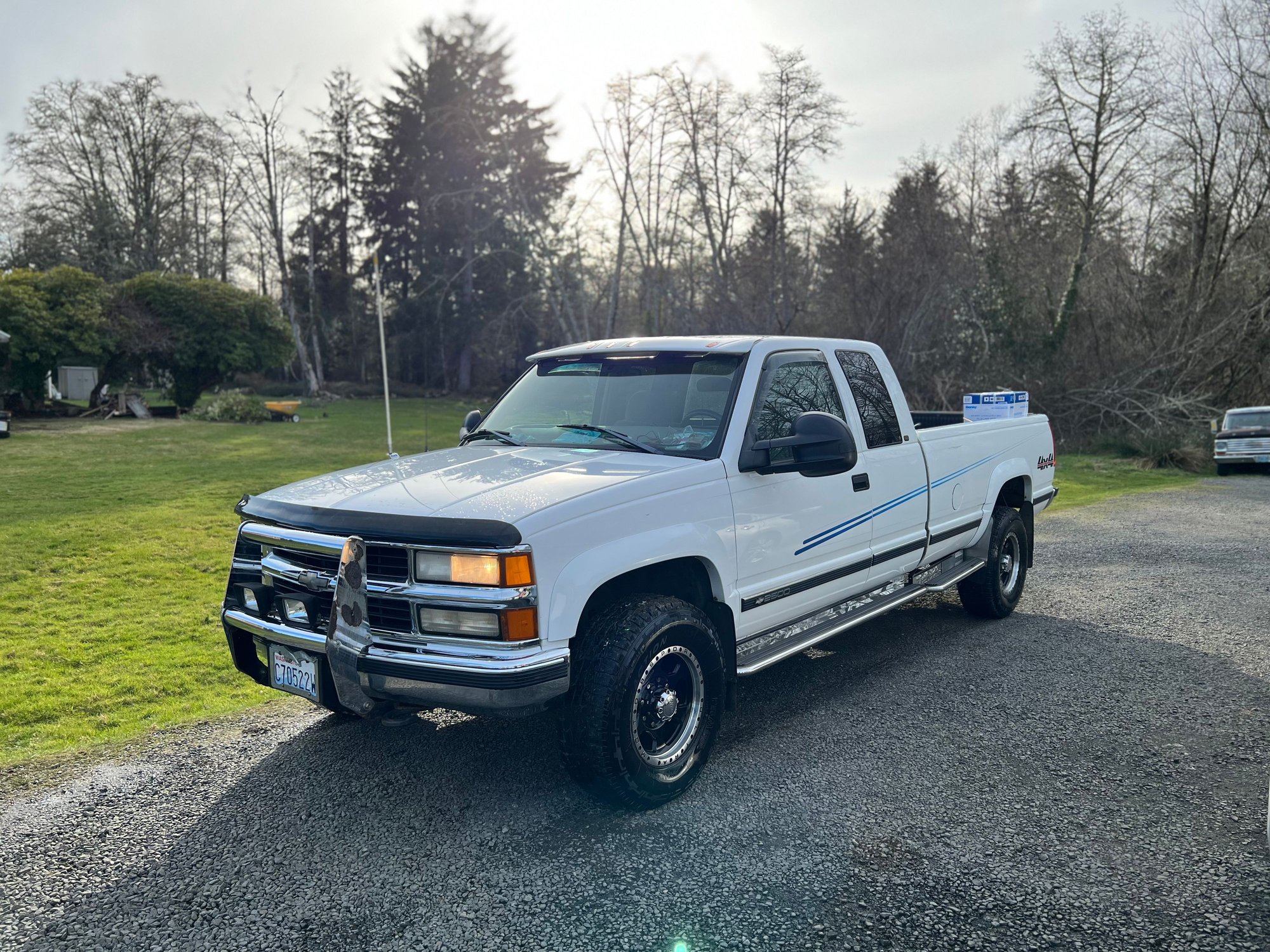

My grandpa has a 1998 K-2500 Silverado
He got a steel on the truck that you wouldn’t believe. It’s got a unique pinstripe on it. At one point it was used to haul something, with a gooseneck. Came from Eastern Washington, I think they hauled horses with it because the pinstripe detail and rims on it. Musta been some cow girls truck. That’s my guess. It’s geared down a lot with a heavy duty trans in it. About 2k rpm at 55mph without a trailer. We use it for hauling my project vehicles and as a work truck and other stuff. You guys wouldn’t believe how good shape this truck is inside and out. Hardly a scratch on it. It’s time we diagnose the electrical problems it has.
Starting off, It has a problem with the gas gauge going nuts back and forth, empty, full repeatedly. It has a new fuel pump in it. Thinking it’s the gauge motor?
Next problem is the Fan. If you don’t drive the truck for a few days the blower motor doesn’t work. But when you drive it for a few days it kicks in. It turns itself too high, then low. Repeatedly. Doesn’t matter what position the switch is in. After a while it just stays on full. Thinking it’s the resistor?
Next one, the radio center console doesn’t light up when the Running lights turn on. All the other lights work.
The wipers sometimes keep running when they get shut off. Or if you just put them on low they go full blast.
The hazard lights don’t work, when you flip the blinker on it doesn’t work, but the dash just shows the blinker indicators both on steady. Then you gotta mess with the hazards button to get the blinkers to work.
Also the lumbar support doesn’t work on the drivers seat.
I believe that’s all? I’m not sure. Thanks I’m advance!
