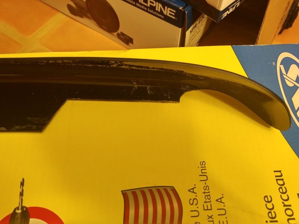

Hi,
The results are in. So this is an all acrylic, one piece deflector, looks just like the one I had on my '91 a long time ago. Guys at the shop found that the only way they could mount it following the instructions - and still have the hood close - was to mount it very shallow, meaning that it would stick out in front much further than it should. This was because the grille mounts were in the way. The far left and right grille mounts, right next to the corner of each fender just under the hood, were in the way. For it to look "right" (aka, sexy-cool) it needed to be pushed in by another 3/4 inch so that it sat about a half-inch out from the front edge of the hood.
The only way to make this work would be to cut out about 7 inches from the mounting surface from both ends so that the deflector could be mounted further back without those grille mounting points being in the way. This part worked!! They used a Dremel cutter, checking and rechecking to make sure they only cut away what they needed to, and we were able to achieve the proper mounting depth.
However... once we were sure it was ready to install, they did a test fit and found that the hood would not close. There wasn't enough space between the hood and the grille, more so on one side than the other, but not enough throughout. The only way they could have installed it was to raise the height of the hood latch. But this caused the hood to be obviously higher than the fenders which did not look good at all. So in the end, we did not install it.
Now, we talked about why this might be. Dave, the most experienced guy there who worked for a dealership for years and knows these trucks well, speculated that two things might be factors. First, there is more variability in the fitment of external parts on Chevy trucks than people realize - whether brand new or 20 years old, and whether early model or late model (someone else could pull in with another 1998 Silverado like mine, and the deflector might fit just fine on that one.) Second, my grille is an aftermarket one from LMCTruck.com. He said the specs on it could be off just enough that the grille rides a bit higher up than it should.
I really like the look of this deflector - Bugflector II by AVS. Sporty but not too swept back, and wraps just right to cover the fender corners. If installed the way I want it, it would look just like the "Michael Hicks" white 1996 that is currently featured on the LMCTruck.com website.
If I still want the deflector, he recommend that I try an OEM grille to see if that solves the clearance issue. So, kinda bummed, but it was a learning experience. Oh, one more thing. I called the technical assistance line for AVS after we tried all that, and their recommendation was to raise the hood latch, so...
I'm not giving up on it though. If/when I get a new OEM grille I will try again.

top corner grille mounts prevented us from mounting it as deep as we wanted to make it look right.
the cut-outs we did worked - we got the depth that I wanted. (but my truck didnt have enough clearance between grille and hood to install it.)
