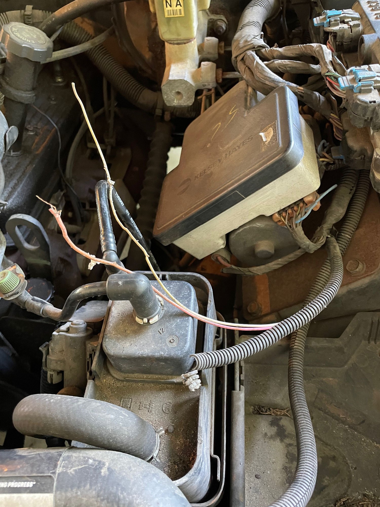

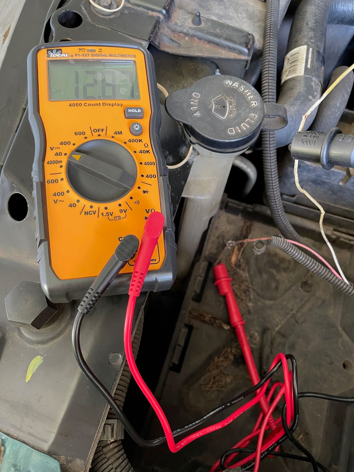

I'm going to do some testing tomorrow, thanks for the guidance. I may have also found the electrical issue. After some engine compartment investigating I found 2 wires just dangling down near the brake area. The insulation was cracked and missing in spots, with the engine running they had 12.9v on them, a little less with the key on only. Appears to be one red and one white wire, any suggestions as to how to figure out what they connect to. I cut them off clean and taped the ends so they can't cause any problems.Attached are a couple of pics.
Goes to a large harness at the firewall.

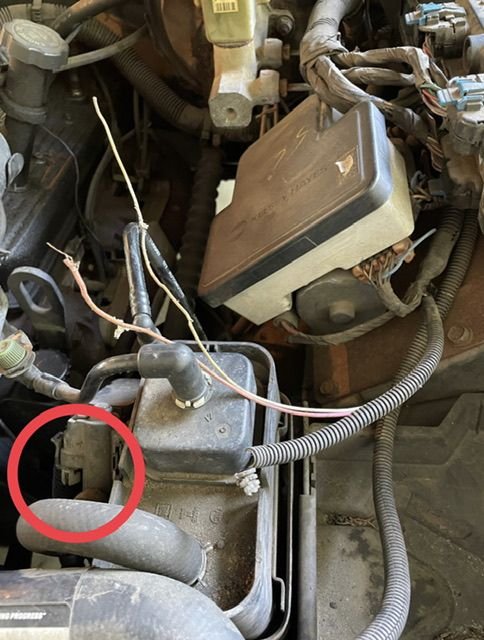

Is this the other end?

Yes it is, same color wires on the connector. I'm going to get a connector and hook it back up. Looks like it connects to the vapor canister and has to do with emissions. Apparently it doesn't affect performance. Looks there are several different connectors that will fit, is there a certain one to use?

It’s the evaporative emissions purge valve - SMP part # S1350 should be the correct replacement for the pigtail.
It doesn’t affect performance - it’s used by the ECM to control the burning of captured vapors from the fuel tank.
Edit: It shouldn’t affect performance. If it gets stuck open it can pull excess vapor or air into the manifold which can cause relatively minor driveability problems.​​​​​​
