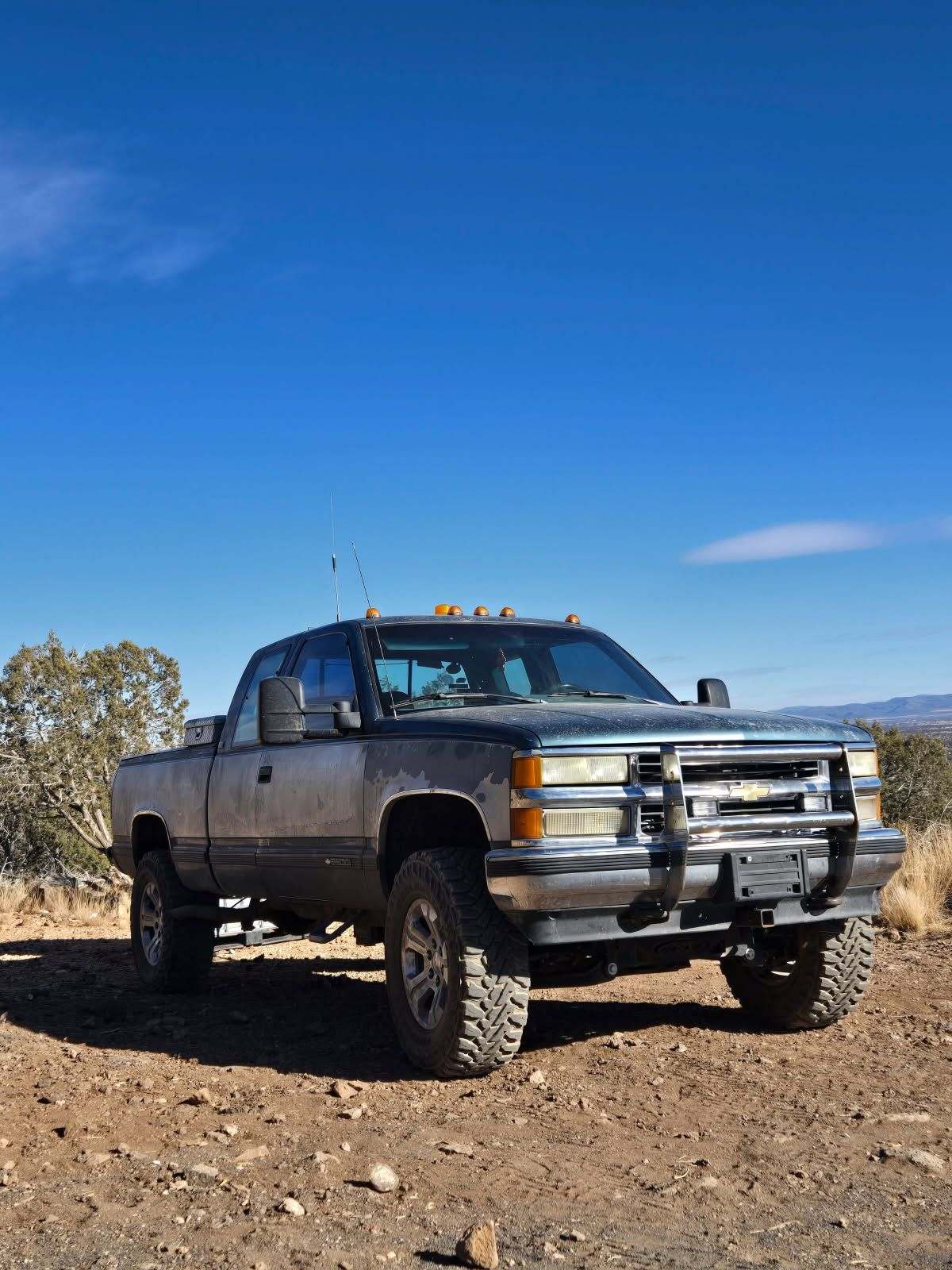

Looking for suggestions right now i have the 305 but it's a bit sluggish it has a th400 trans I beleve what can I swap into this truck that will bolt up I beleve it has a carb but the swap will definitely be carb since I don't want to play with computers right now

It's a 91 k2500

So here's my issue the 305 in it runs mint no ticking nothing wrong with it as I can tell idels perfect but it takes a minute to get up to highway speeds I can floor it and it goes nowhere
