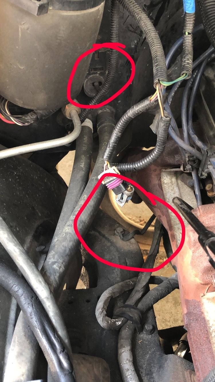

On the frame there was 2 ground straps I removed one because it wasn’t connected to anything. Does anyone know where it goes? The one hooked goes to the block up the metal tube. I don’t know where the second goes. I think I’m also missing one where I circled up top on the firewall. I’ve looked over and the only one I can’t find is the one from the cab to the fram​​​​​​​e

dont think it goes on the firewall as that looks like a plastic backing. maybe trans?

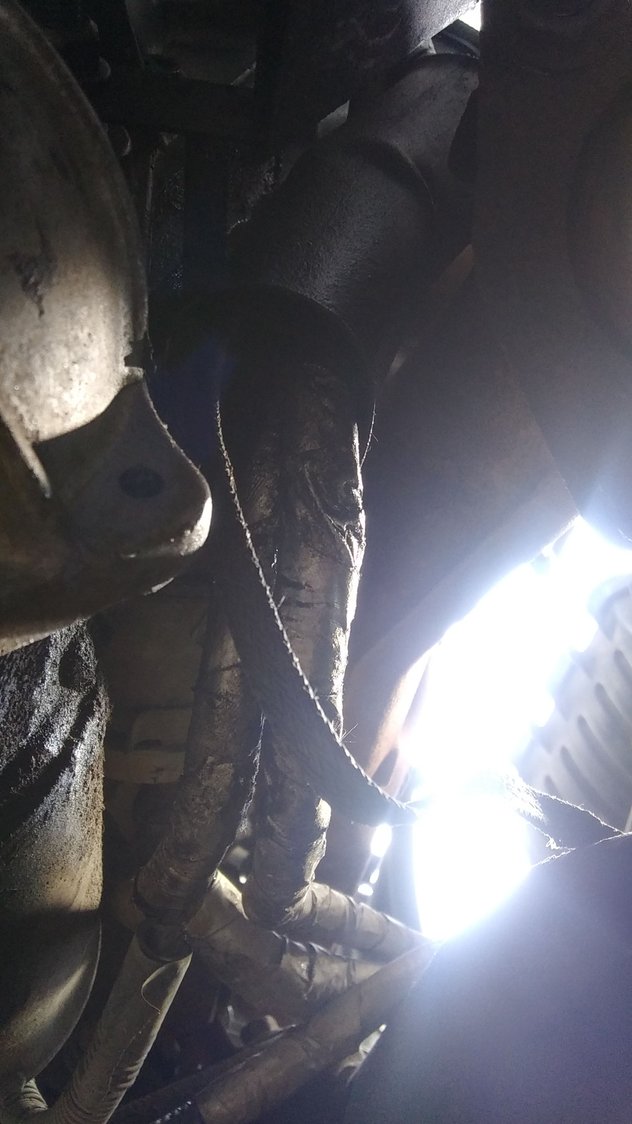

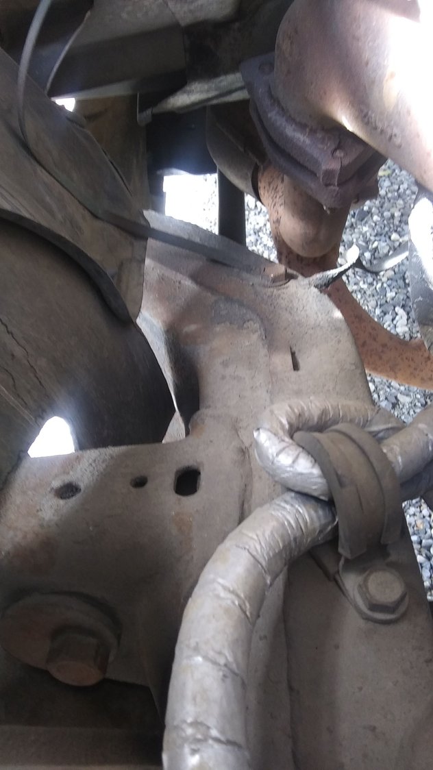

Hope this helps. It starts under the heater core hoses on your firewall then goes down to frame then daisy chains with the second strap to back of engine block
Old May 13, 2019 | 5:56 PM
vortec5.0's Avatar
Joined: May 2019
Posts: 15
the metal tube it goes through is just a heat shield.
