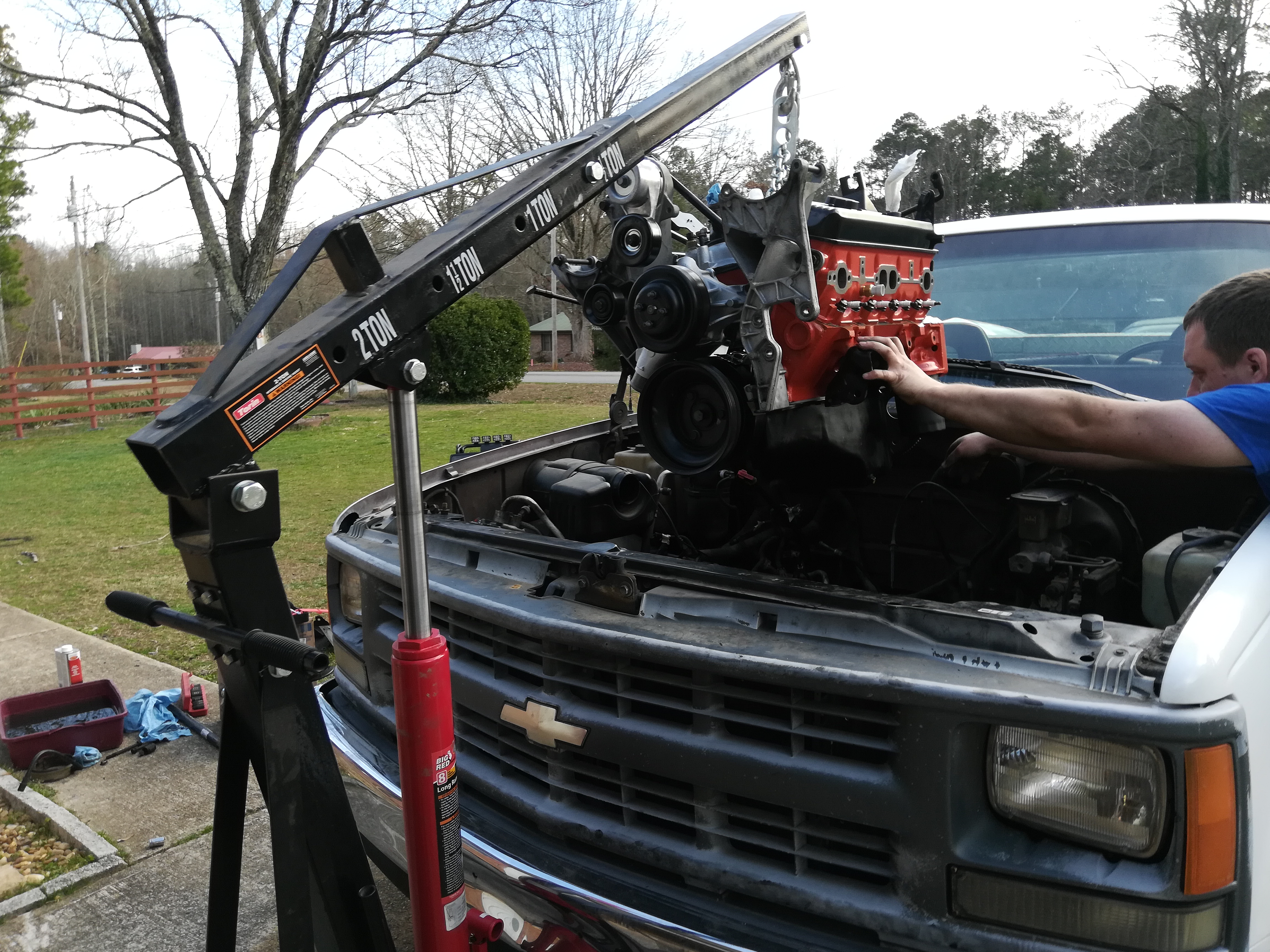

Well, the engine is in and now the fun really begins. I'm learning that more than one sensor and ground need extended. The starter on the 5.7 is much larger than on the 4.3, and the larger cable won't bolt onto the starter. The hole diameter is too small. I've currently got half the wiring hooked up though. The transmission is fighting me, and for whatever reason I can't get it connected.

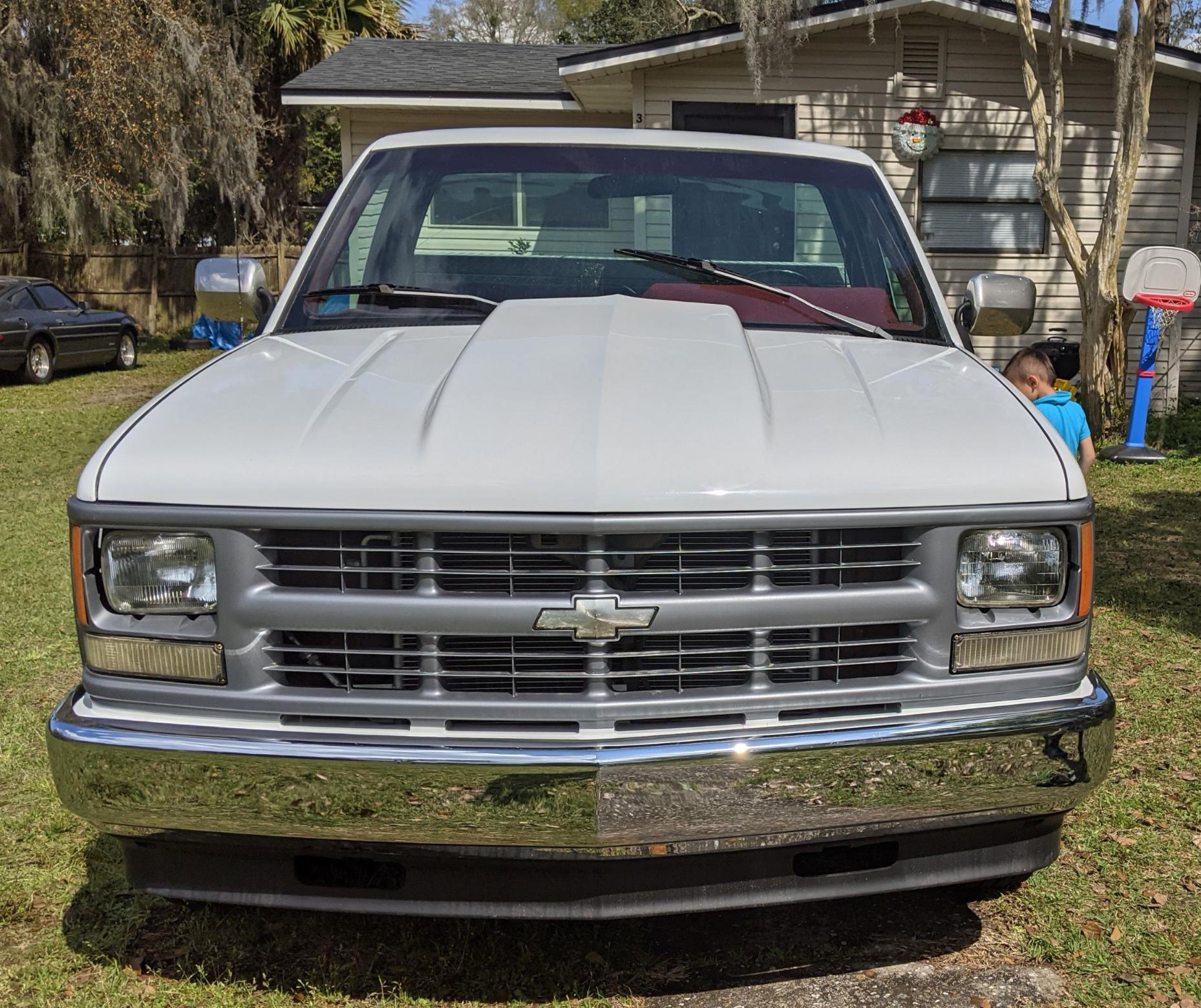

Been kind of demotivated lately. Just moved to Florida, and my wife was involved in a relatively minor accident while driving the truck. Fortunately everyone was ok. The truck had just gotten it's second oil change, a new air compressor, and new exhaust too. It's currently getting looked at by a body shop.

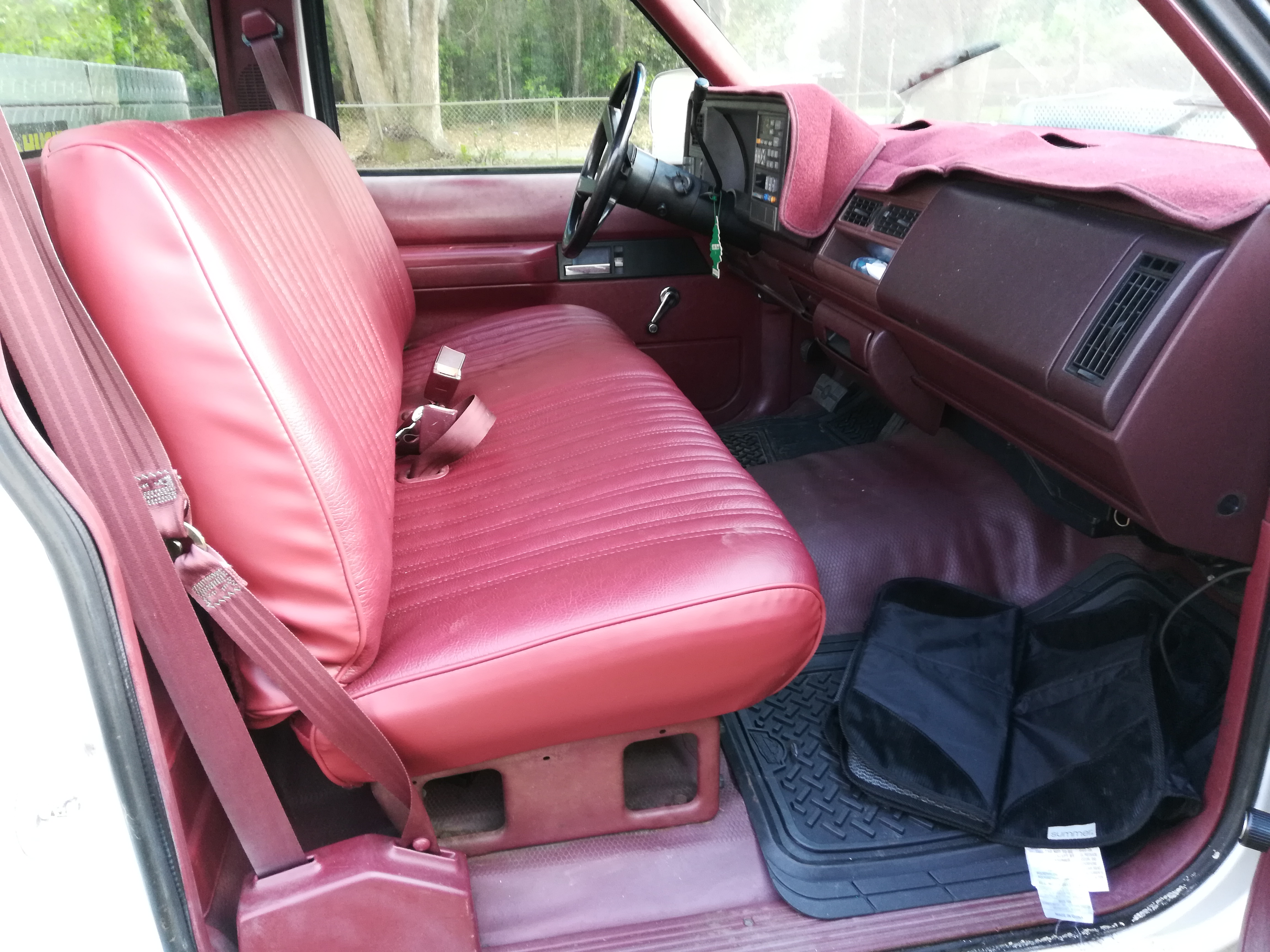

I finally got the truck repaired. I had the bench seat re-upholstered as well. Headrests were deleted, but the gentleman who did the work told me he can add them back if I buy new ones and want them installed. I drove it ~25 minutes to the gun range today and the CEL came on when I got there. It reset after shutting the engine off and didn't come back on during the drive home. I'm happy it's been fixed as it's been a rather depressing incident for us.
