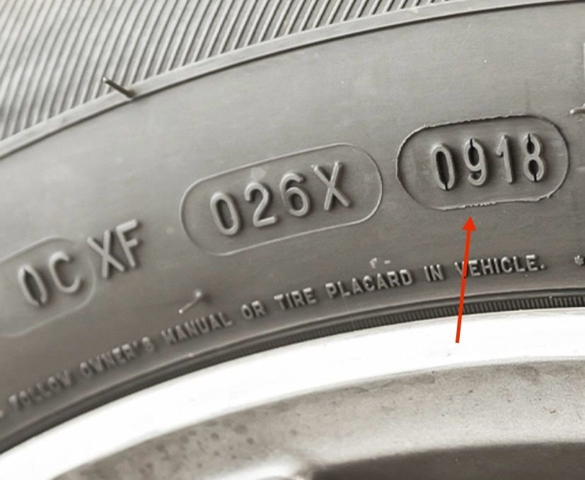

Based on age alone, 6 to 10 years is the recommendation, according to most tire & auto manufacturers.
To add to what MMJ said - it really depends on condition, more so than age.
Besides low tread, cracking/dry rot (also called weather checking) is for sure a sign that the tires need replaced. Any bulges in the tread or sidewalls also merits replacement, as does any low speed shaking as a result of a slipped belt.
In the US, tire makers are required to date stamp tires - at least for automotive applications - I’m not sure about agriculture or other off road vehicles. The stamp is a 4 digit code on the sidewall (sometimes one, sometimes both), with the first 2 digits marking the week of manufacture, and the last 2 marking the year - 0918, as pictured for example, would mean the tire was made in the 9th week of 2018.
I don’t know if there’s similar requirements for other countries.
