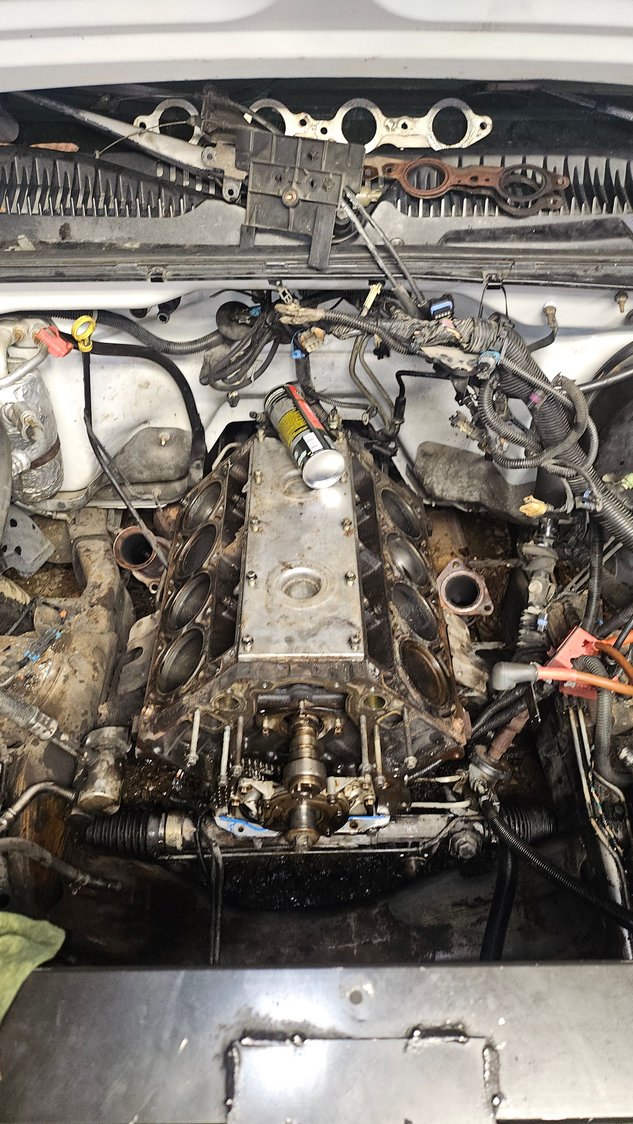

To update thread , spun cam bearing and broke it in half , sure seems like it would had been making a hell of racket. I found a fresh block out of machine shop comes with all new bearings, crank was checked and cleaned up , has bunch new parts for 500 , guess guy needed the money. Just gonna build the new one , now trying decide if I should put little cam in it or not , nothin crazy. Got a local guy that can tune it for 400. Seems like a good idea since I won't have much $ in it
Old Feb 23, 2025 | 7:58 PM
Ls life's Avatar
Joined: Dec 2024
Out with old  almost ready
Fresh out machine shop.  Any gurus got any suggestions on improving or cheap power mods while im putting it together.  This my 1st ls im building,  have done a many old school sbc and bbc , actually this is 1st ls thats went down on me but lookin forward to fresh motor
