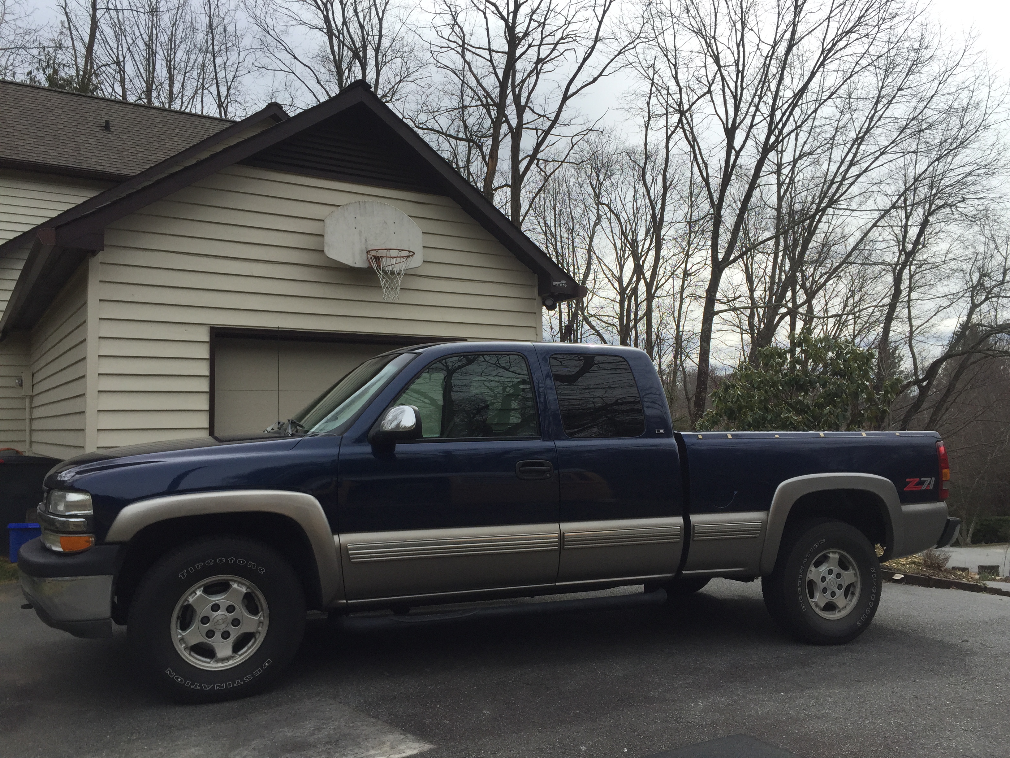

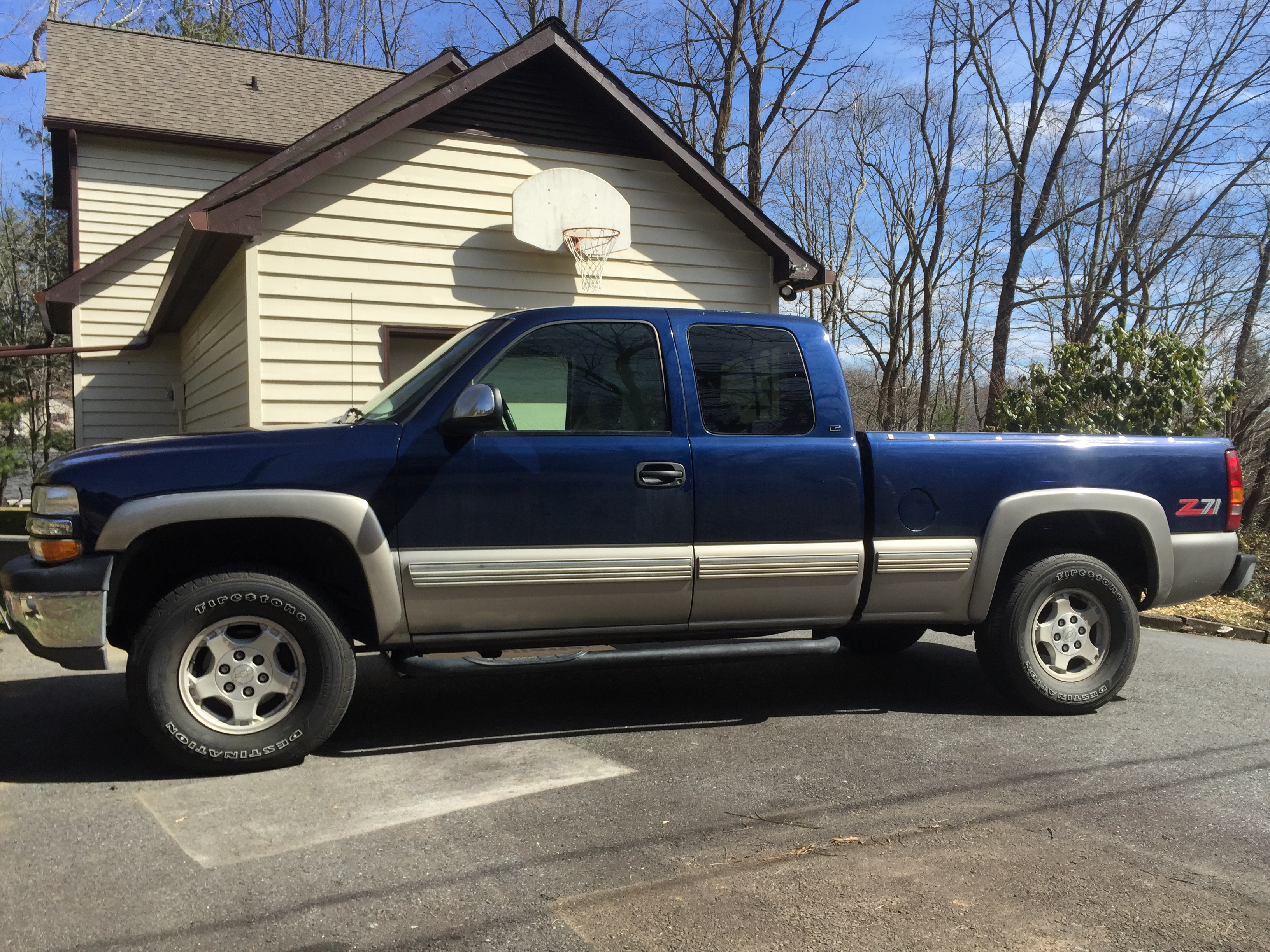

Well, I finally put the new Daystar torsion bar keys on my truck over the weekend, and I am super happy! It rides and looks so much better!!
Before I started the job, I wanted to double check about whether or not I needed longer adjusting bolts and/or shock extenders, so I emailed Daystar and they were very helpful and said, "No". I would recommend Daystar products, great customer service too!!
I rented the torsion bar puller tool from AutoZone ($80 refundable upon return), and got the job done in about 2.5 hours. The hardest part was cranking down on that puller tool to get the new keys in.
I started with the top of the front wheels measuring about 4 1/4 inches from the wheel well, and finished about 3" higher!! Check out the before and after pics! Again, it rides and looks so much better!!
I plan to check the measurements again and fine tune the adjusting screws (if necessary), and then get the front end alignment done in the next few days after the new keys/bar position settle in.
Also, want to give a shout out to Tech 2 on here for responding and helping me out!! I really appreciate all your time and help!! Thank you very, very much!!
I hope this thread helps someone else out too! Keep on Truckin everyone!

Old Mar 13, 2017 | 7:59 PM
  #13
the pics tell the story. looks good.
