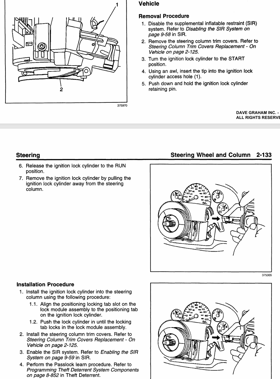

Idk wat the hell happened to my last posting on this site but y'all suck I took the time to rite out my issue to try and amplify sum kinda tips here and I just got a email as I'm doing something else to tell me that my post was removed ... Thx 🖕🖕🖕I need to no wat position the ignition switch Tumblr weel needs to be in to align with the lock cylinder... Don't sit there n tell me to YouTube or charm etc etc. Etc I. Been doing my research since practically April in this whole entire ignition set up and if anyone could simplify it any more in a YouTube video then I would not be posting this thread....

Here's what my FSM shows, for my 2002:
