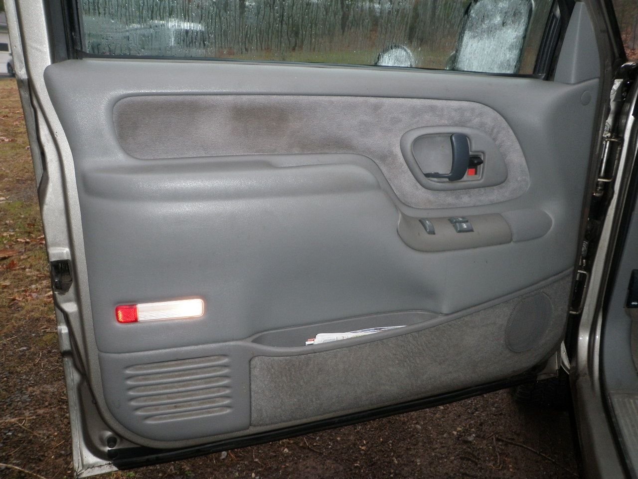

post a pic of the door trim panel. Your vehicle year is at the end of a generation change so the panel could be either the old bodystyle or new bodystyle.

Here is the pic of the inside front drivers-side door. I had the ring around the door handle off and the power window/lock panel off. I had two of the push-connectors pulled out at the back of the door (left side in photo). I had the triangular piece at the upper-right pulled off as well. If it is like most inside door panels, once the connectors are pulled out the panel should lift up from the window channel and come right off. The videos I saw all referenced one or two screws that need to be removed. There are two screws directly aft of the door handle in a finger-hold that you grab to pull the door shut. I had those out also.
I don't think the linkage is broken because if I mess with it long enough, I can get the door to open using the inside handle. If I can get the panel off to see what the problem is I can probably fix it myself. But I don't want to break anything that will cost me a small fortune to have repaired.
