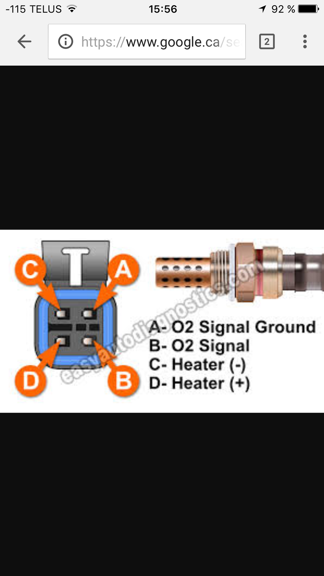

disconnect the 02 sensor connector. check for battery voltage on the pink wire with the koeo = key on in run engine off.
if that is ok, put a test light between the pink wire and black/white wire. turn the key koeo...the test light should blink on and off
Old Apr 24, 2017 | 2:58 PM
Alexandre Levesque's Avatar
Joined: Apr 2017
I got 12v between C and D...how come its suppose to blink with a test light?

the dtc is set due to a fault with the heater circuit. the other dtc that set from the 02 not responding quickly enough from the sensor not reaching temp is a predetermined amount of time. fix the heater circuit dtc and you fix the p0134
the pcm pulse width modulates the heater on and off. Its low driver controlled so the grd is turned on and off, power is supplied at all times by the fused circuit that you have checked.
You must test this with a test light as you must simulate a load...a dvom does not do that.
