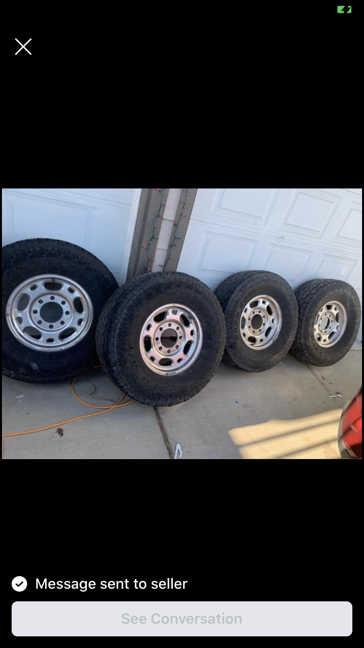

I’ll be picking up a 2004 2500 in a couple of days. Current owner has aftermarket wheels on there, and I’ve been looking for a set of stock. Found these on Facebook and am considering buying them, but I have a few questions. Seller says they came off an 05 2500hd. Will these rims fit the stock 245/75/16 tires? He has 285/75/16s on there right now. Don’t know enough about these rigs to know what rims Chevy produced. Anyone recognize these?

yes, this is a stock rim. they will fit the stock tire size.
when buying used rims....inspect the lug bolt holes and make sure none are oval....signs of a lost wheel.

any safety concerns running the bigger tires on that wheel?
Old Dec 29, 2020 | 8:07 PM
clearance in the wheel well...probably ok.
speedo error and trans delayed shift points as the speed input is off. this can be corrected by changing the tire size in the ebcm. scan tool needed.
