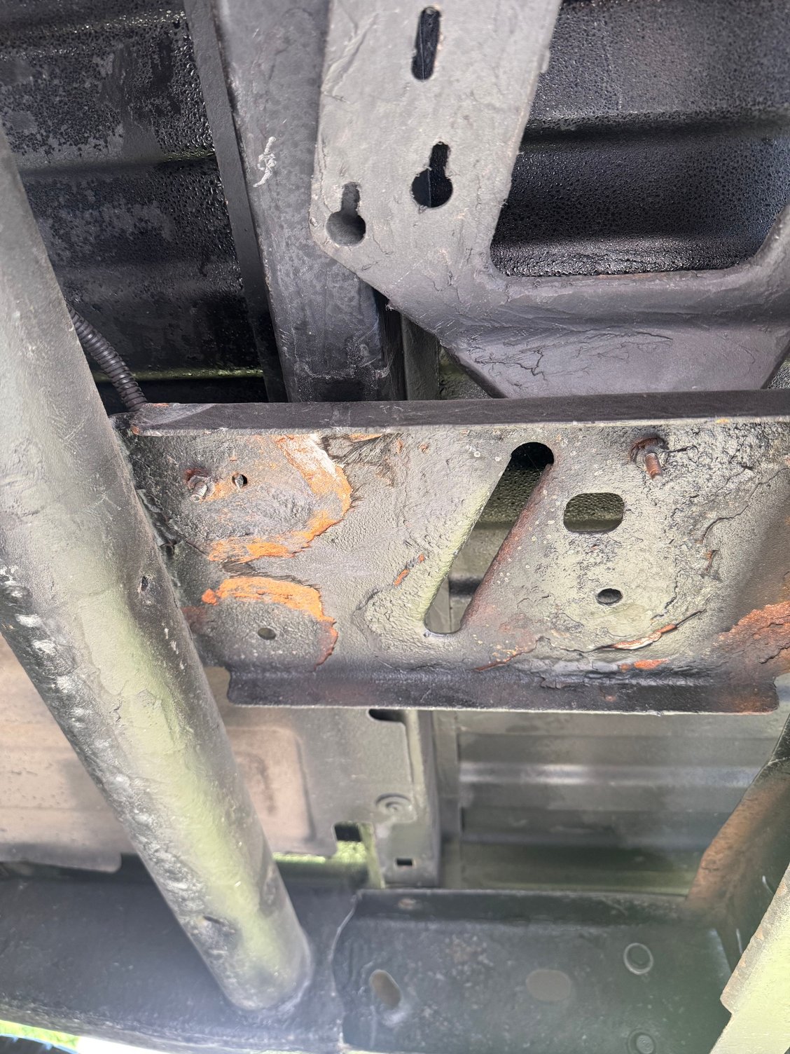

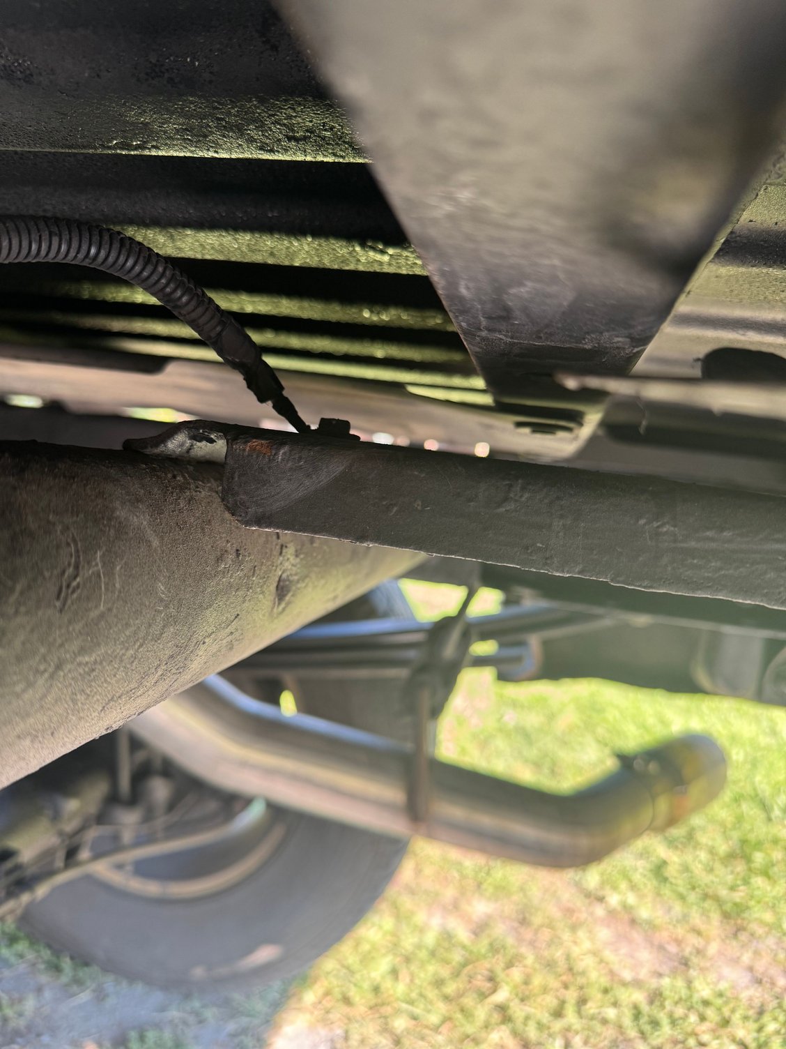

Old Sep 13, 2024 | 8:23 AM
nrfogel729@gmail.com's Avatar
Joined: Sep 2024
Gr
Ground for tail Light Lamp located above spare tire rack.
Ground for tail light lamp location
