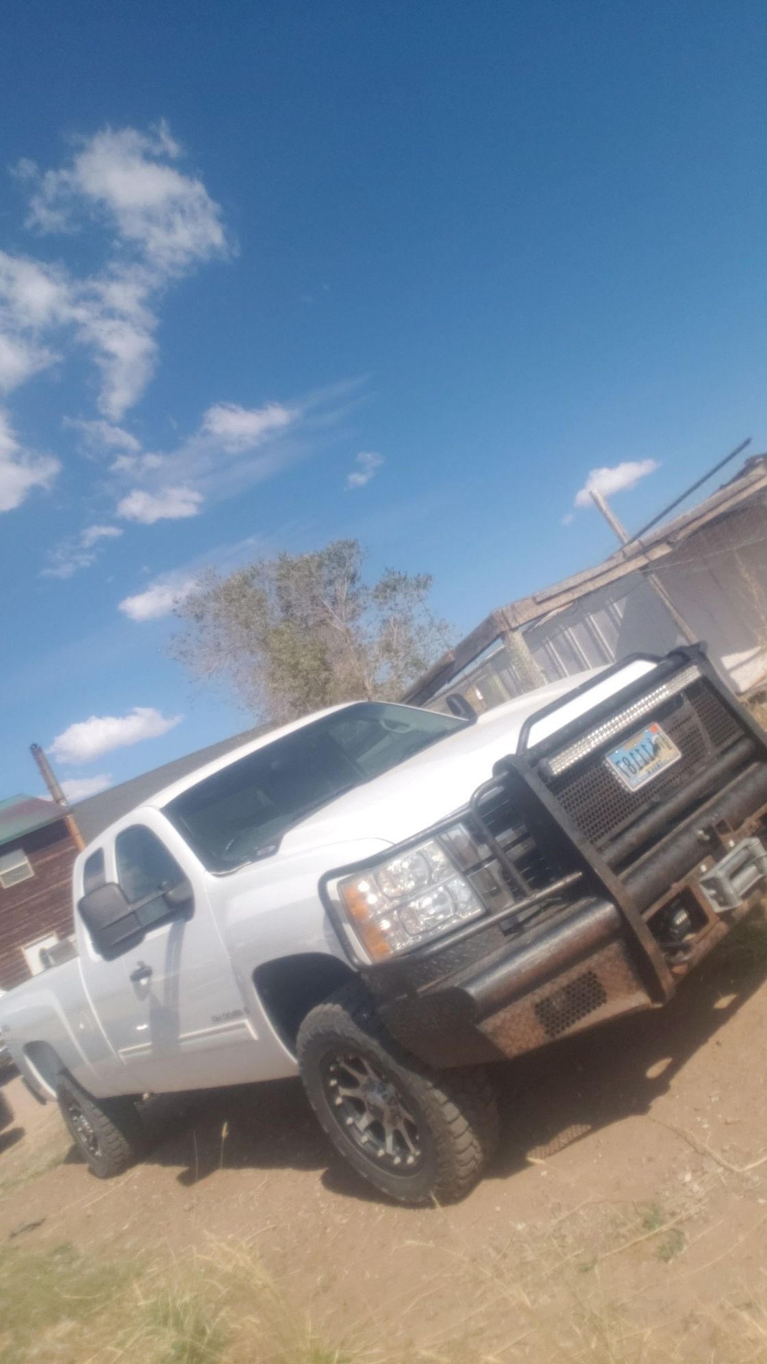

My father works for a cellphone company and bought it from them about 5 years ago, we both used it to haul trailers all over and haul tons of loads, its got 230k on it and the transmission finally went, so my father went and bought another one from the company for cheap and gave me a smokin deal on this one. I have some mechanical experience, replaced a few engines and transmissions, but im wondering what the cheapest route would be to fix this truck. Im not even 100% sure what transmission is in it, I think it would be the 6l80 if someone can shed some light there. Should I find a used one, buy a reman, or is it possible to rebuild the trans? Will be doing the work myself. Thanks in advance.
