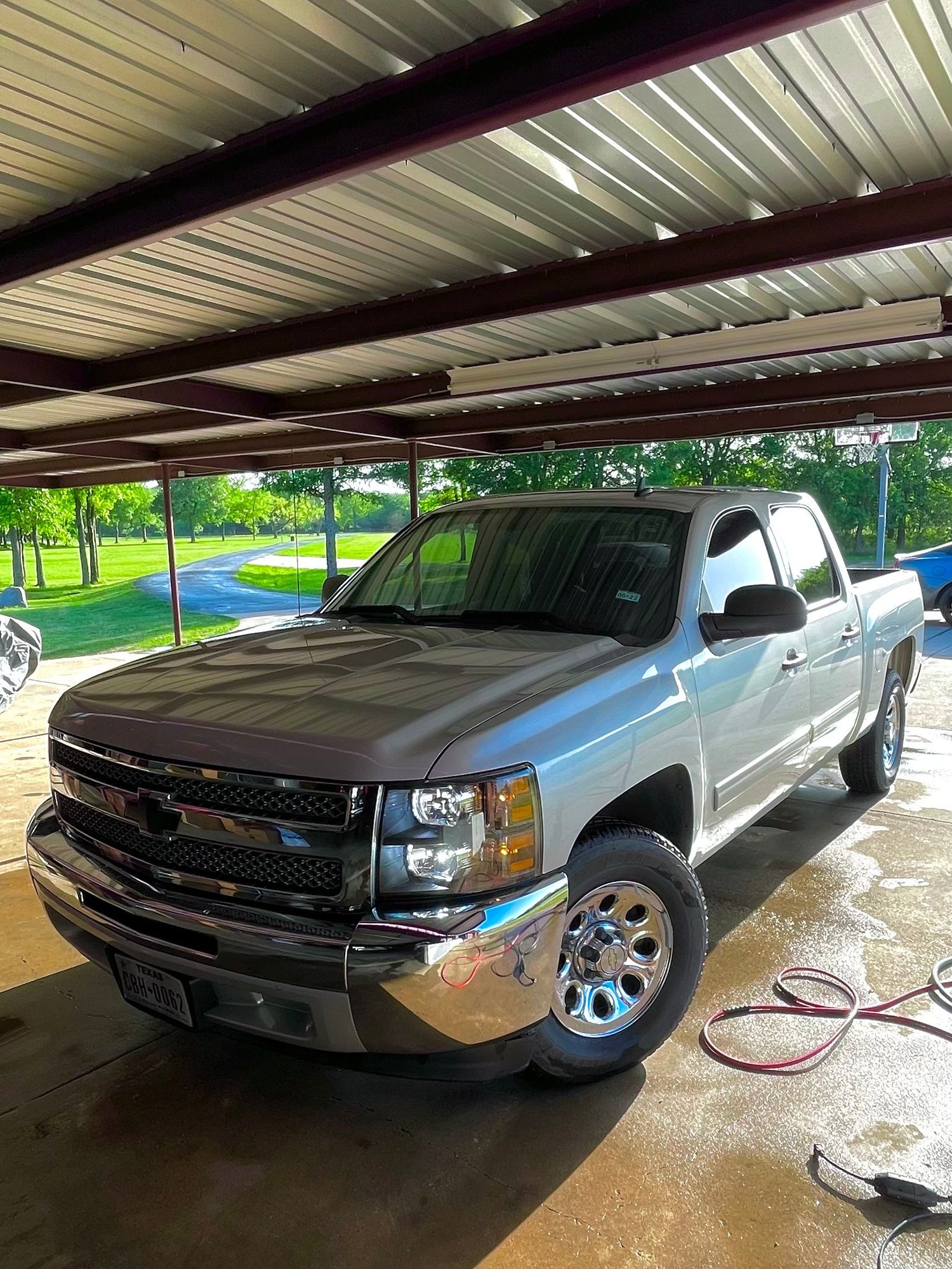

I’ve recently bought my truck from my grandparents. It is a very well maintained and just hit 73,000 miles 2013 Silverado LT. What would be the best upgrades for making it run the best for the longest?
