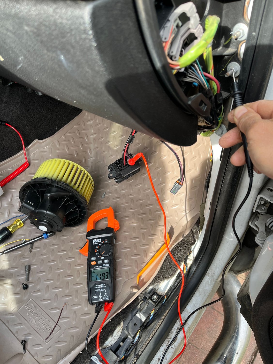

Here are some pics. I just noticed that multimeter shows ~12v with or without ignition key on

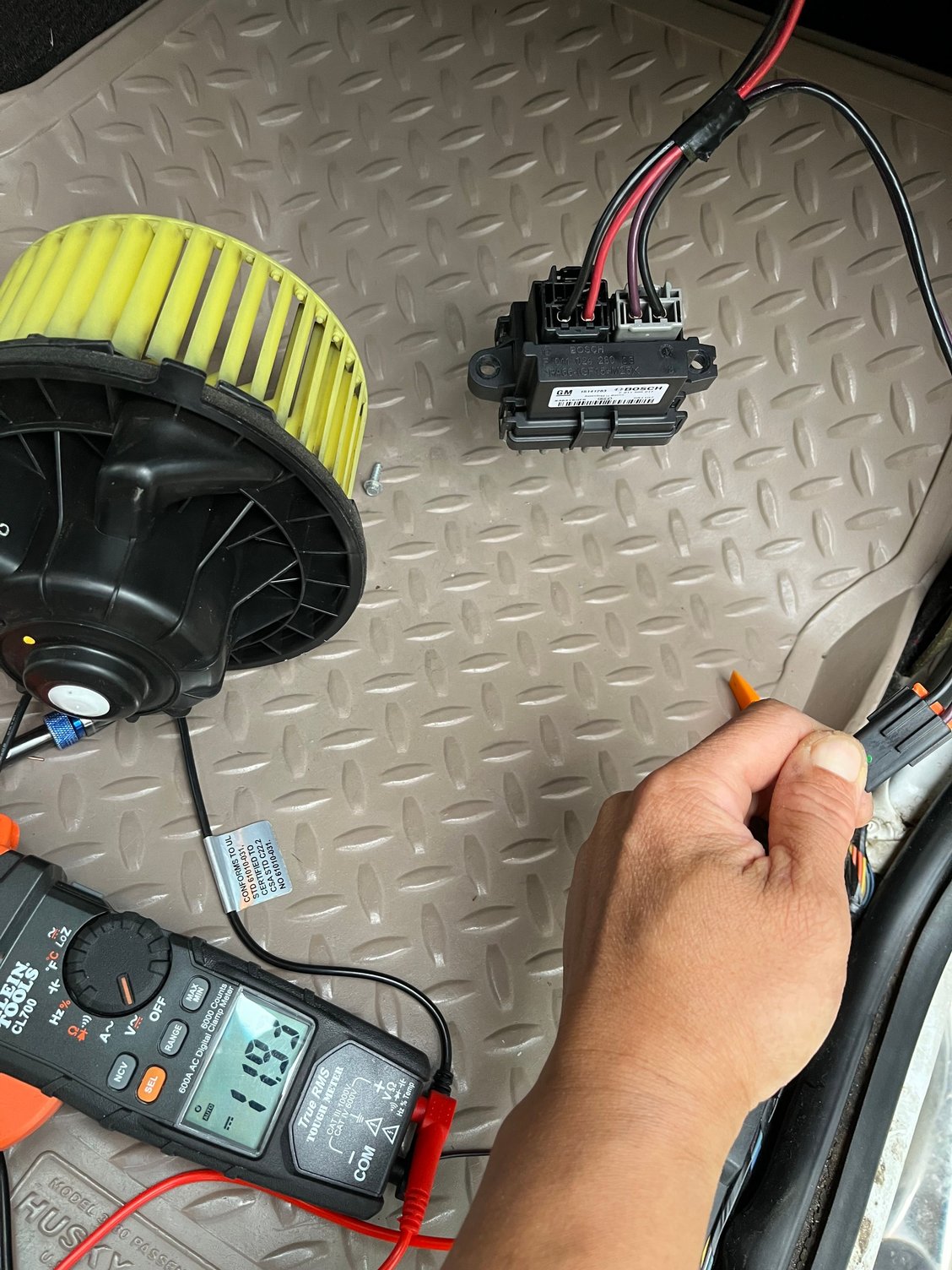

tests i did today:
resistor wires are continuous (no short) from side of door, please refer to pic 1
Battery was unplugged.
Trying to answer the ground question from mountainmanjoe,
i have: battery and blowing motor connector:
- measure battery + to blower negative =11.8v
- measure battery - to blower += 11.9v
i also tried blower + to a grounded screw =11.9v
