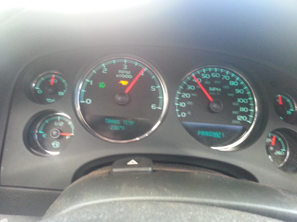

On our last trip out West, our gross weight was 15,000 lbs, and we were on I-70 approaching the Eisenhower Tunnel (11,100 ft). The engine seemed to be in its sweet spot at 4,000 RPM. Here's a pic of my gauges during this pull:
