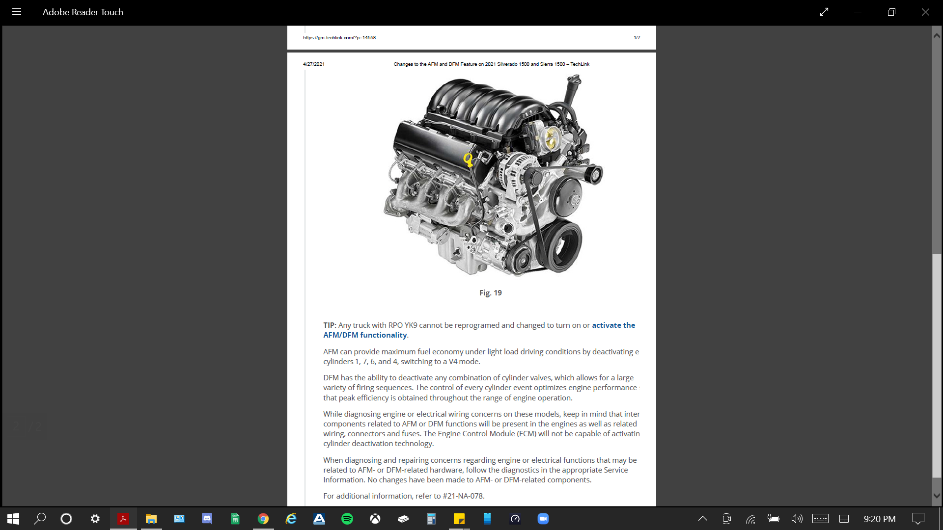

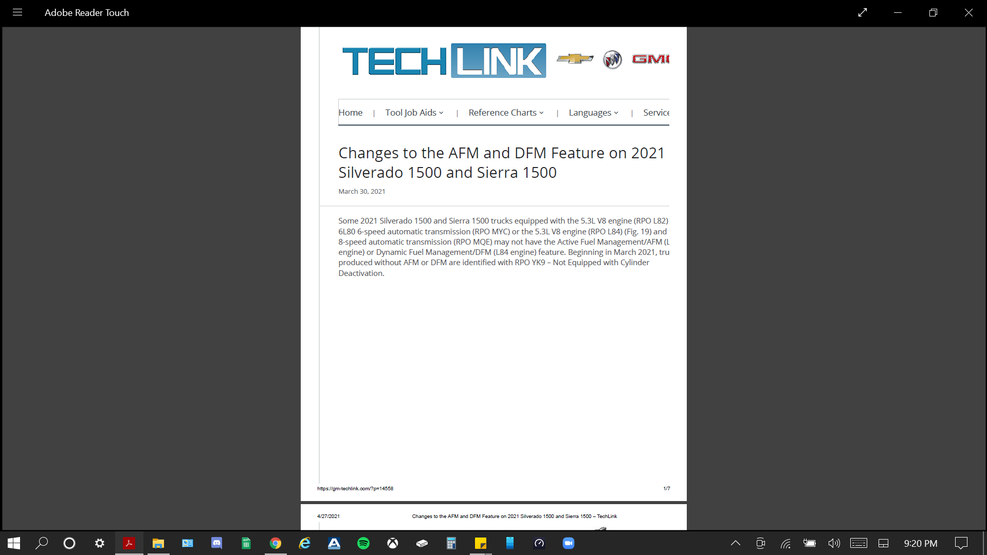

Yes you can actually, and I feel like these are going to be highly desirable trucks. Here is a copy/paste from the tecklink page.
"Some 2021 Silverado 1500 and Sierra 1500 trucks equipped with the 5.3L V8 engine (RPO L82) 6L80 6-speed automatic transmission (RPO MYC) or the 5.3L V8 engine (RPO L84) and 8-speed automatic transmission (RPO MQE) may not have the Active Fuel Management/AFM (L82 engine) or Dynamic Fuel Management/DFM (L84 engine) feature. Beginning in March 2021, thru produced without AFM or DFM are identified with RPO YK9 – Not Equipped with Cylinder Deactivation."
Last edited by Coja; Apr 27, 2021 at 9:24 PM. Reason: added picturs of the Techlink page

If you’re hoping to avoid the mechanical problems related to the AFM, you won’t. All the components (mechanical and electrical) to operate the AFM system are installed on the engine - the only difference is the PCM isn’t equipped with the chip to turn the system on and off.
So, the weak points of the system (lifters, for example) are still likely going to have failures. Time will tell for sure but I wouldn’t get too excited about it yet.
