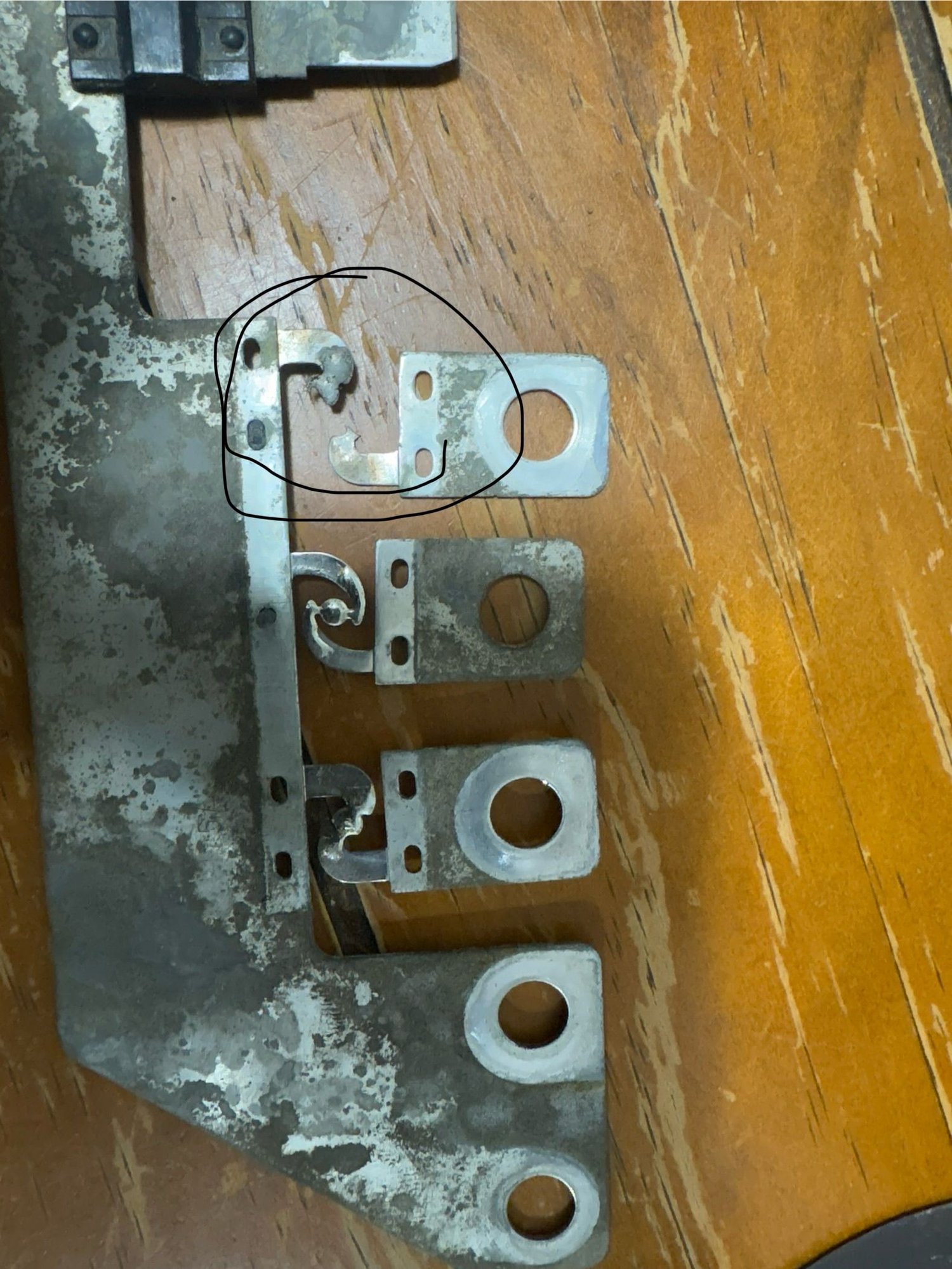

the was the problem. The fusible link on top the battery. Moved the cables onto the post that wasn’t being used and bam started up and has been running fine. The fuse I popped was a 175 and the one I swapped it over to is a 125. Don’t know what caused it to pop nor how long a 125a fuse will last. Drove truck all day yesterday and didn’t have an issue.
It's great you found the issue. Moving over to 125A fusible link is a great temporary fix but I would get a new fusible link so that you can get that circuit back up to 175A. It looks like you might not be able to get the fusible link by itself, at least not from GM.
https://www.gmpartsdirect.com/oem-pa...block-84354716
I mentioned "ground (or harness) issue somewhere under the dash" because of the debugging the OP had already done under the hood and also because he had an issue when he tilted the steering column.
