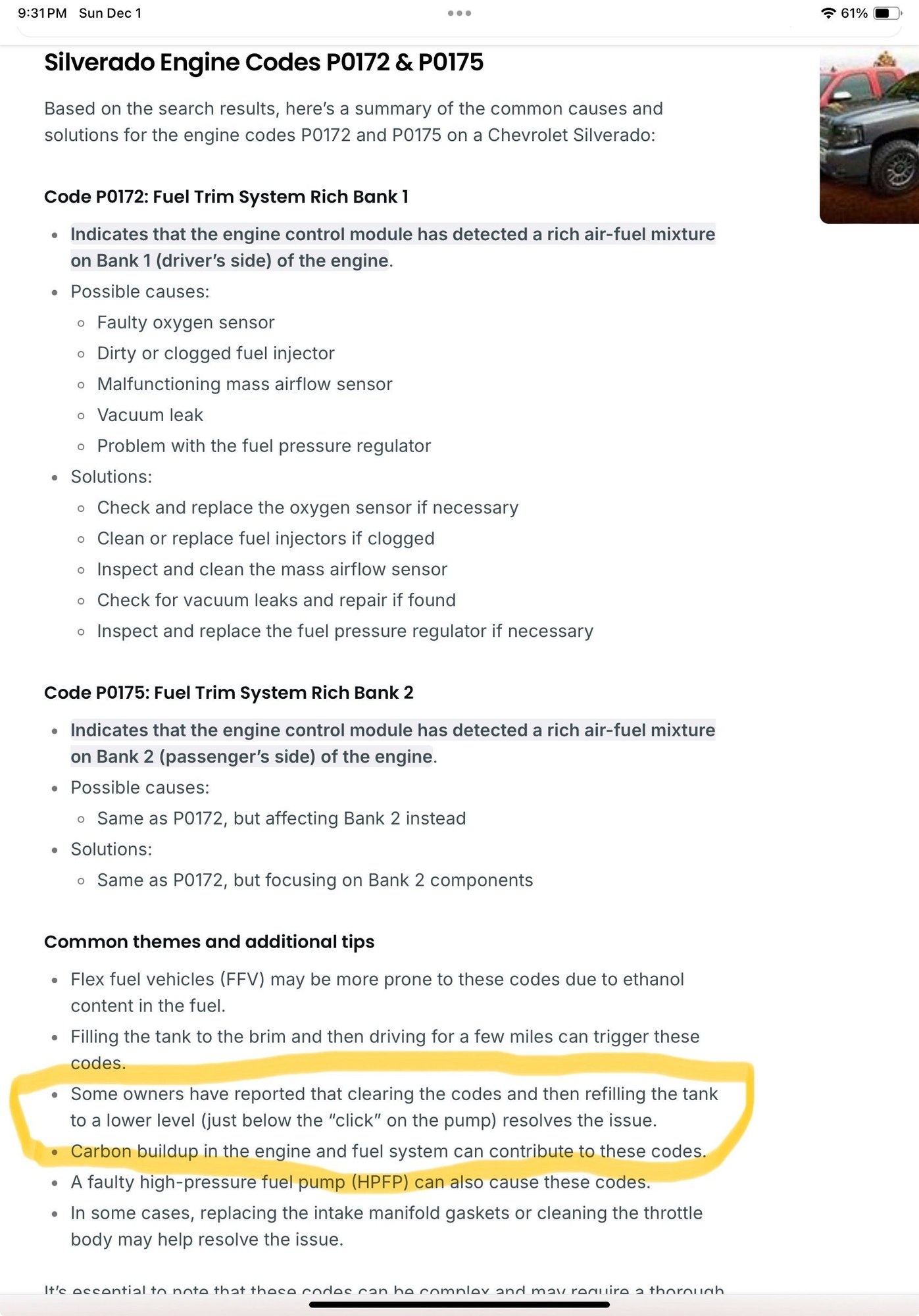

I just bought a 2014 Silverado LT Z71 5.3L 4x4 with 125k mile’s 6 weeks ago (Oct ‘24). I’m also getting periodic check engine lights and these two codes (P0172 & 5).
My internet search produced this:
The last parts states: “It’s essential to note that these codes can be complex and may require a thorough diagnosis and repair process. If you’re experiencing these codes, it’s recommended to consult a professional mechanic or a Chevrolet dealership for proper diagnosis and repair.”
I circled the refueling part because the previous owner said he also got the check engine light at times and thought this was the problem. After a lengthy discussion at Auto Zone, I plan to change oil and do a tune up (but it may not require new plugs - I understand #8 is a bear.) She also suggested checking the PCV and from a SilveradoSierra.com forum on P0172 & P0175, it looks like this is another likely problem (repairing leak in line to PCV seemed to resolve his problem. Dgm79 posted: “For anyone else this may help, it was the high-pressure fuel pump. Unhooked PCV line/blocked off, fuel trims returned to normal.”)
I’ll try to update here if I find a solution.
