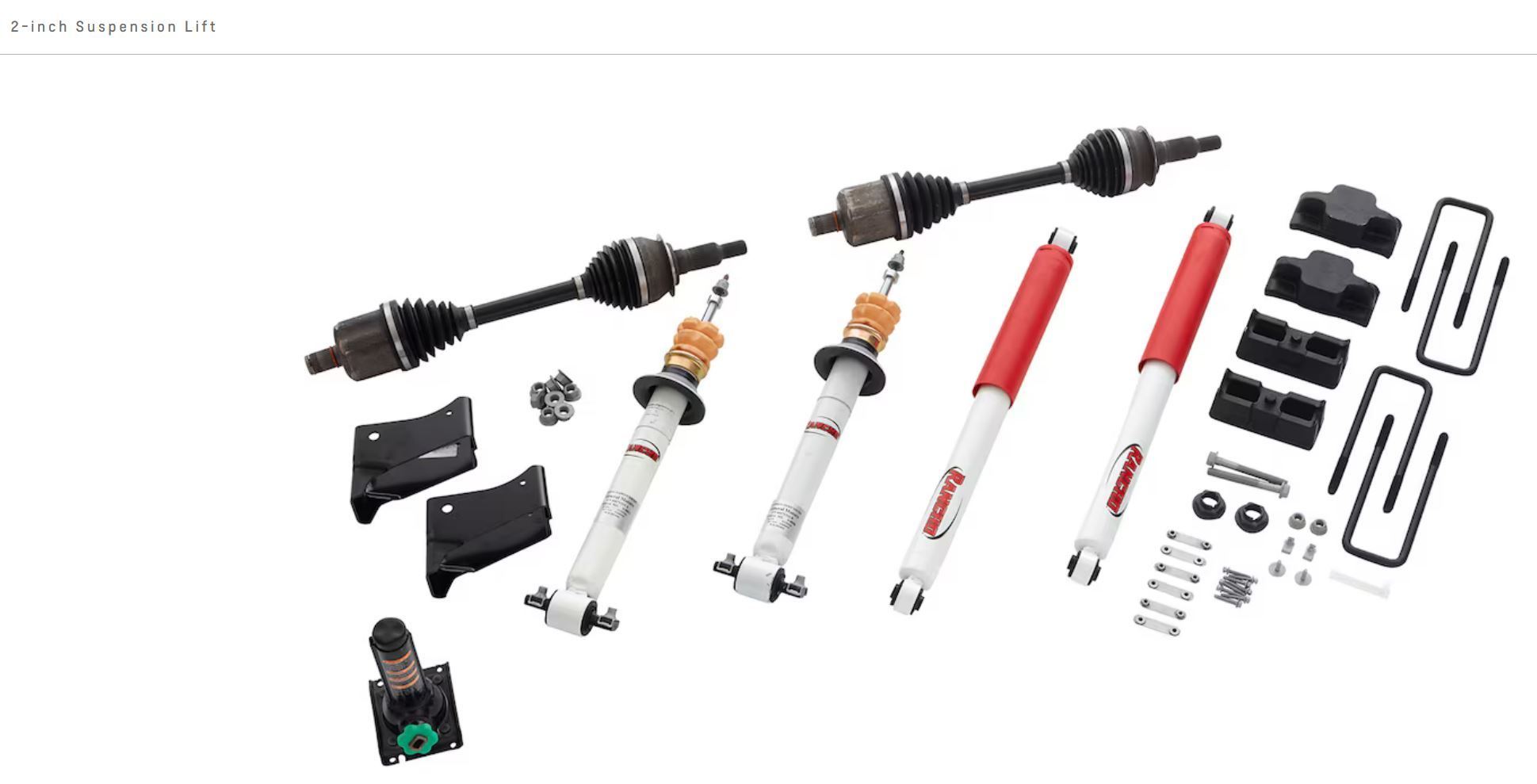

I installed the trailboss lift on my vehicle. These are the parts included in the kit. I didn't compare the cv shaft lengths to the stocks ones but I think the Trailboss cv's are a little longer, you may not need to replace those??? I sold the parts I took off as well, those would have been perfect for you to have. Should be really simple to do. There was some type of programming required for the computer in my vehicle, not 100% sure if that was real or not but maybe it was due to the lane departure system cameras.
