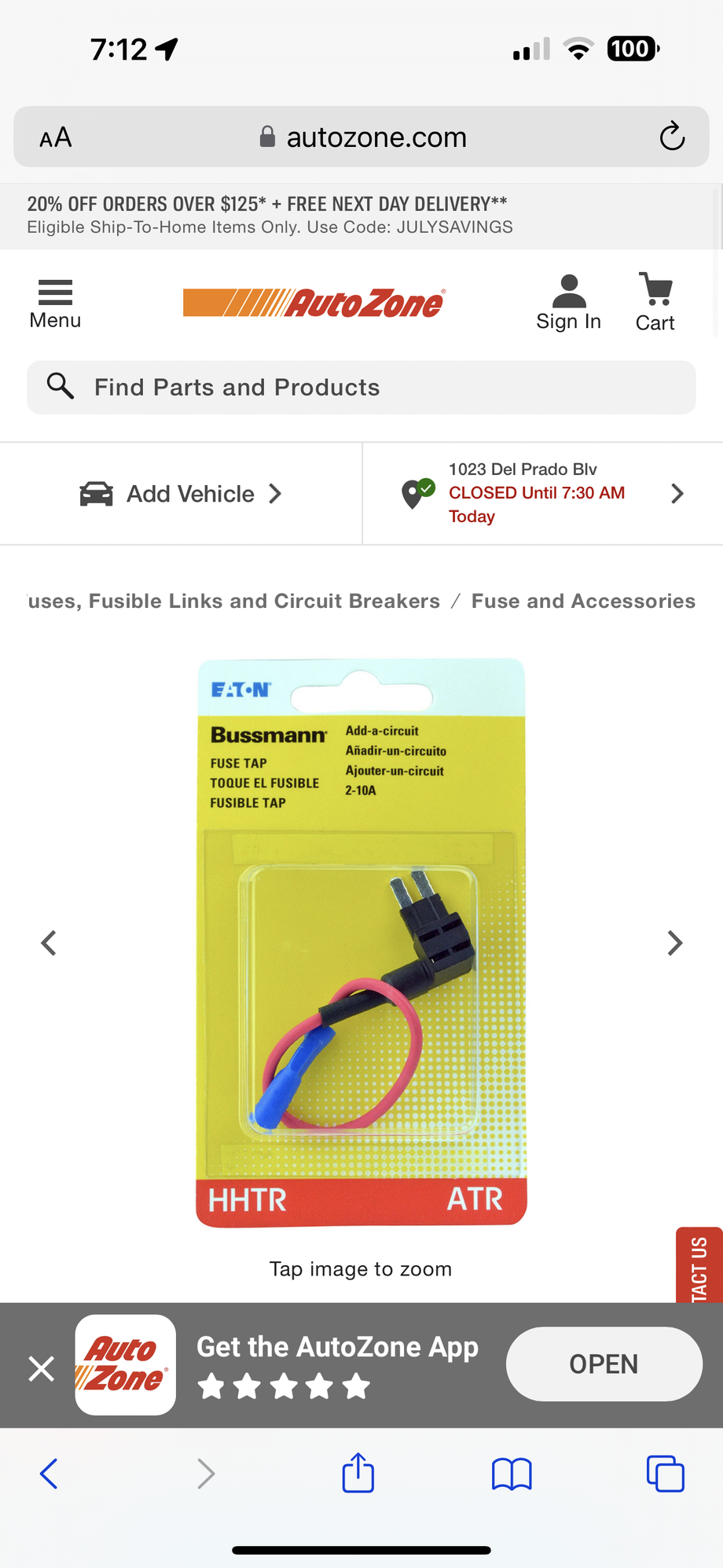

I need help figuring out this amp install. I know the color wires that is needed but in my passenger fuse box there is not remote prong. 2019 Chevy Silverado 1500 LD.
do I need the radio harness?
Can I run this tap to the main radio fuse and get power to the amp?
No. You could overload the circuit.
For power, you should run a new wire to your underhood fuse block.
