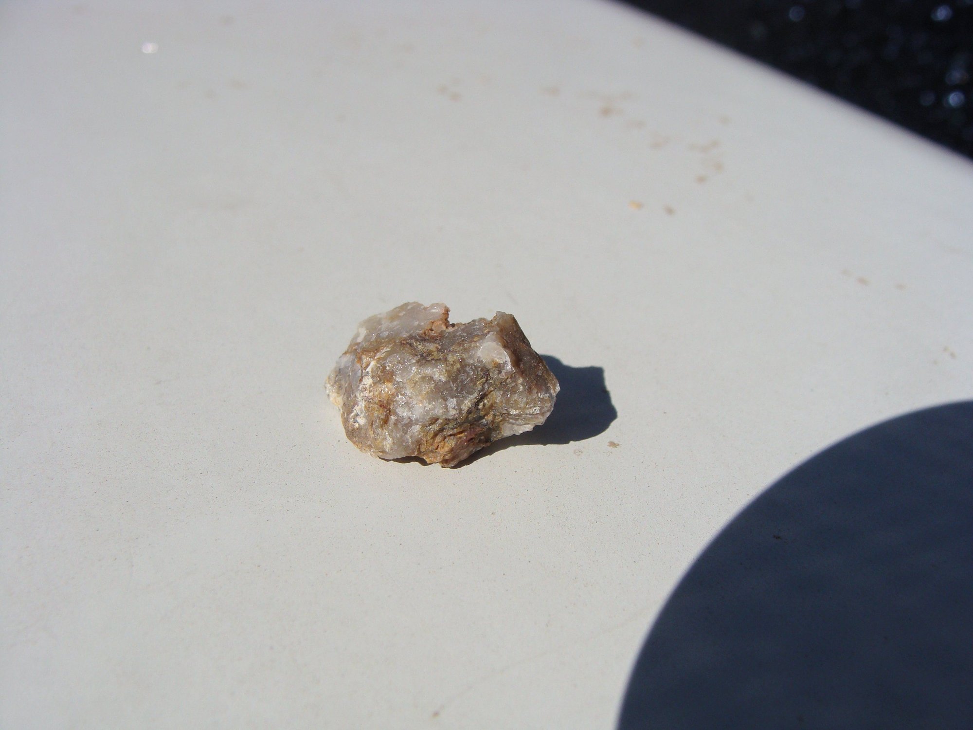

I had the rear window shatter on our Yukon a few years ago and mid-2024 rear window shatter on my '88 Mazda truck, at first thought it was random. I now believe in the first case a pebble from my lawn tractor/mower caused this as I remember mowing weeds that day, and the garage door was open a short time as my daughter came to visit. On the Mazda truck I KNOW it was from a pebble from the mower, see photo. The pebble came to rest on my cross-bed tool box, and the window film saved me from having a big mess.
