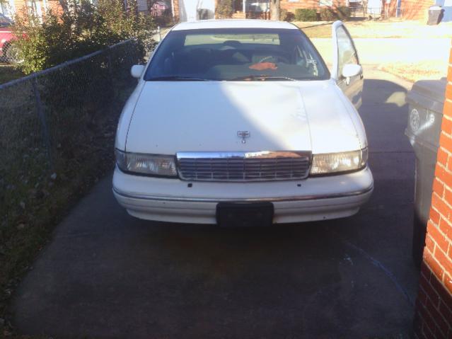

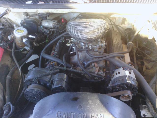

Hey forum new here, I own a 1993 caprice classic, currently I has the stock 305 sitting in it and I was wanting to swap it out, I was wondering what 350 I should or could go in to it without any hassle really want to build this car up and have it looking nice and running nice any info would be appreciated. Mike.

It really depends on your budget, but an LS swap would be the brass ring choice.
A TBI 350 swap would be the most cost effective swap though. It would be best to get the 350 out of a another '92 or '93 B body, there are a few differences in those and the truck TBI's. All the accessories will swap right over, and the motor will drop right in. A mild cam, '96-2002 Vortec heads, and that would be right there with a LT1 B car.

I dropped a 5.7 from an 88 Suburban 2wd into my 92. I had to swap intake, oil pan, valve covers. Everything else bolted right up. Been running it for 2 years now without much issue.
