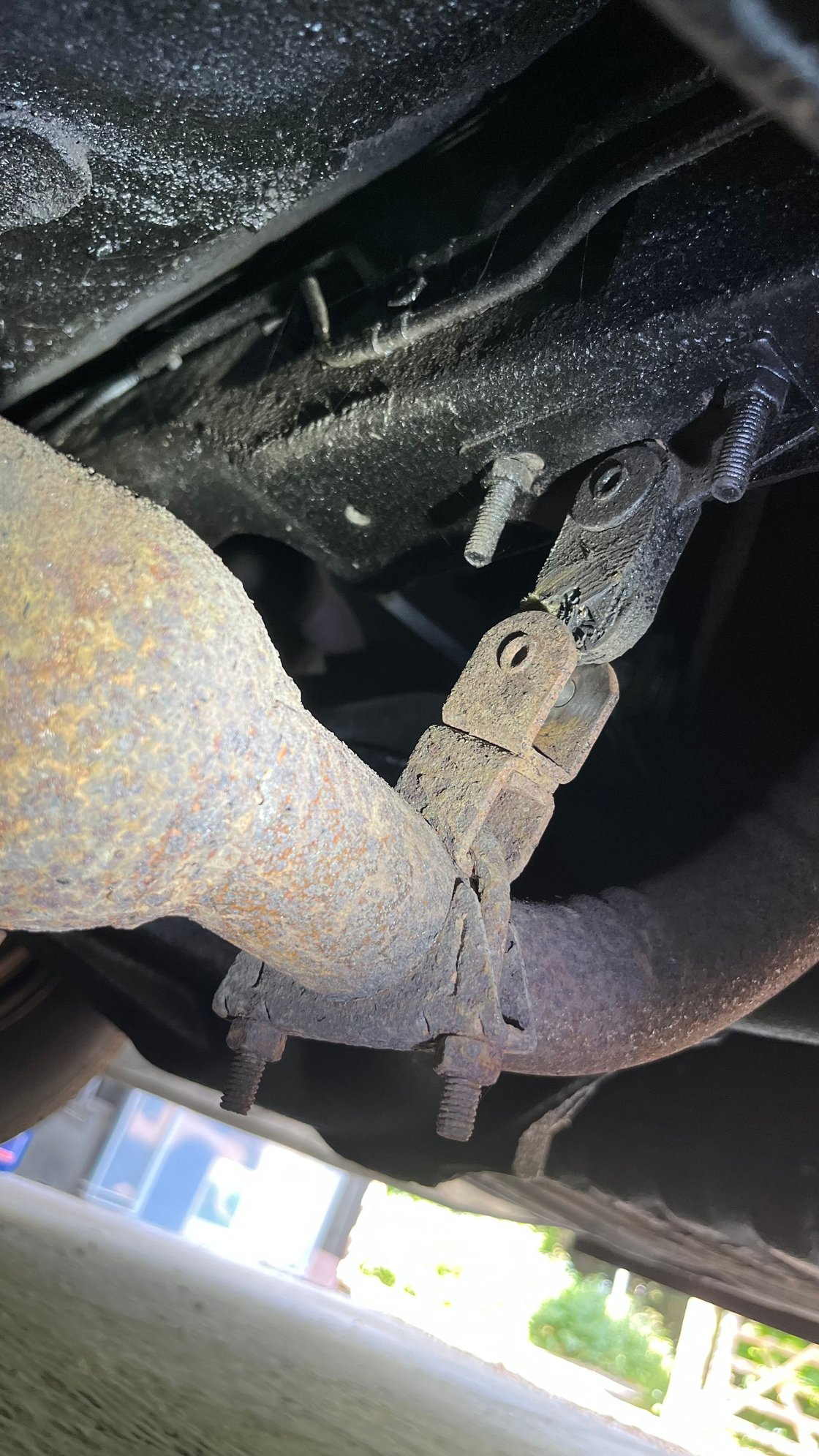

Hi, looking for a replacement exhaust hanger (see pic) but searching for a replacement brings up what I imagine is a generic replacement part: Walker 35210.
the replacement part is quite different from the original so does anyone know if the replacement is any good?
thanks!

Welcome from Florida. All you need to replace is the rubber part. You can drill out the 2 rivets and put in a new rubber piece with 2 new bolts. You can also get the part in the link below. Walker 35210. It only bolts to the frame with 1 bolt instead of 2 and will work fine.

Great, thanks!
