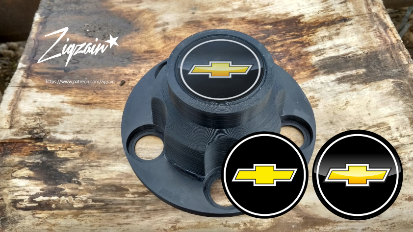

I own a 1992 Chevrolet Caprice Classic Brougham. I bought this car in a bad condition and I had to make|repair some parts by myself. I want to share this.
  • Rally Wheel Center Hub Cap 5x127. These parts is hard to find and may be stolen so I made a 3D model of this part. You can print/customize it as you wish.
  • This is printed hubcaps on Chevy Caprice wheels:
You download hubcaps 3d model there >>>
You can print this in any 3D printing studio or in you home 3d printer: it's cheap and looks good. And so, you can print new one if you broke/lose the hubcap. I used ABS plastic and TEVO Tarantula 3d printer 0.4 mm. nozzle. The bolt pattern is 5x127
I made a two versions: classic and modern hubcap sticker, Then I printed it on the color laser printer (on the vinyl sticker paper) then filled on the top with epoxy.
