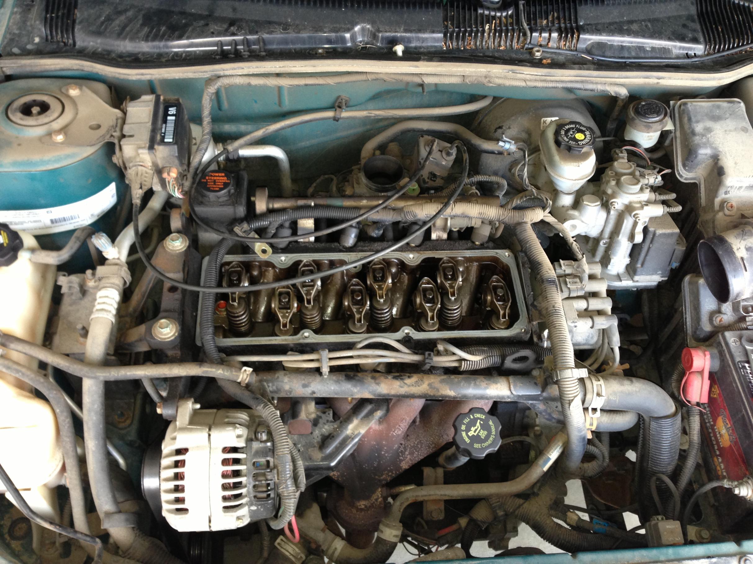

So far I have replaced the muffler bracket as they had it held with a piece of cable, put in a bottle of fuel system cleaner and a full tank of fuel, replaced the valve cover gasket, new AC Delco plugs, new wires, new rad cap, new wiper blades.

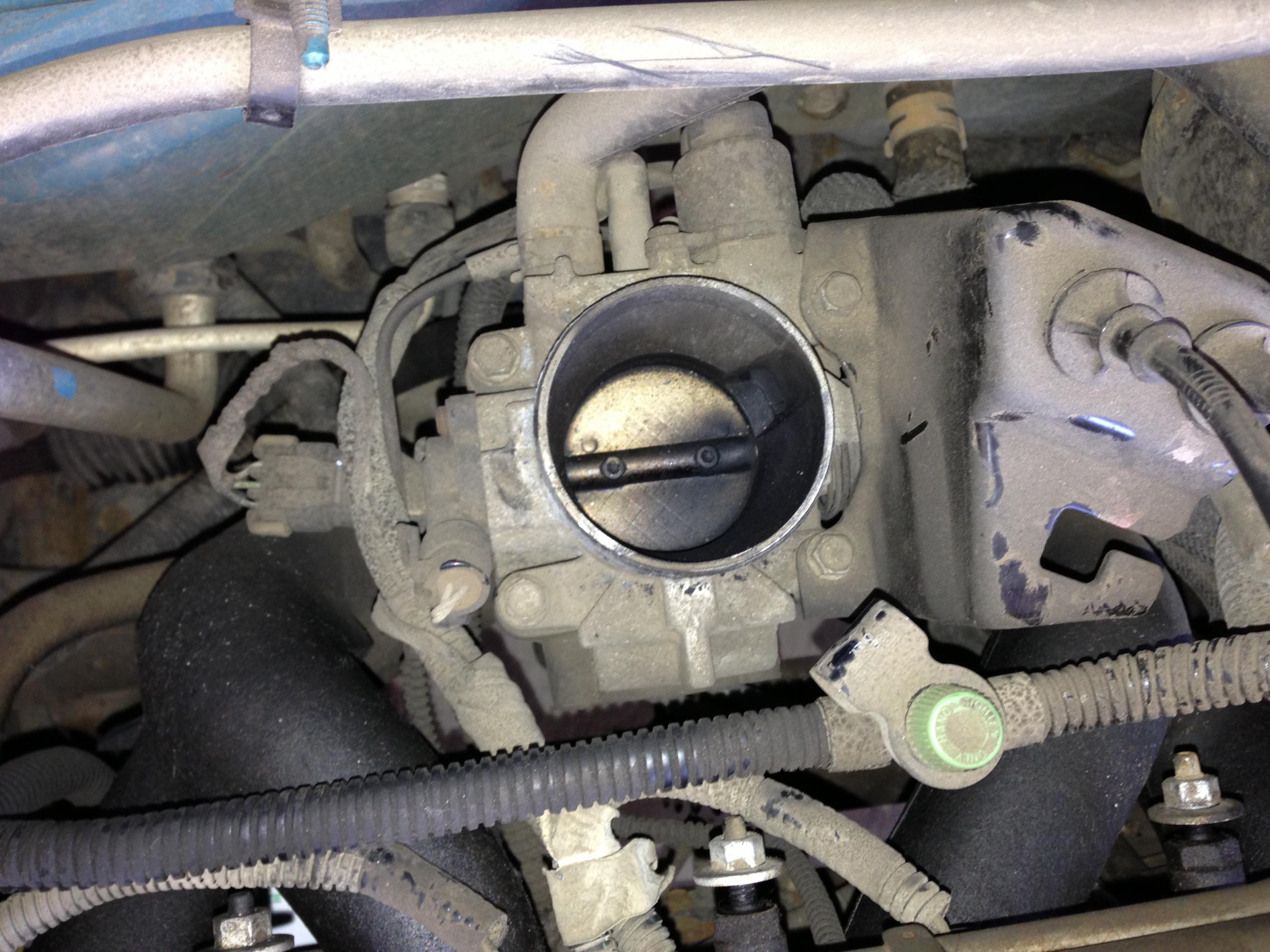

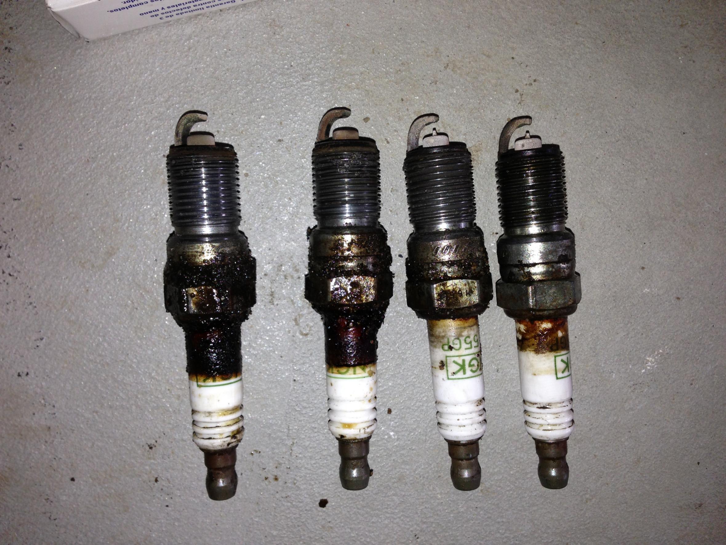

I've attached a copy of photo's I took. Top of the engine looks very clean inside, no sludge build up at all. The spark plugs I pulled out look like they have been in there a bit too long! 2 have no centre electrode left. It had a slight miss at idle and with the new plugs it is a lot better! Also took and cleaned the throttle body the best I could!

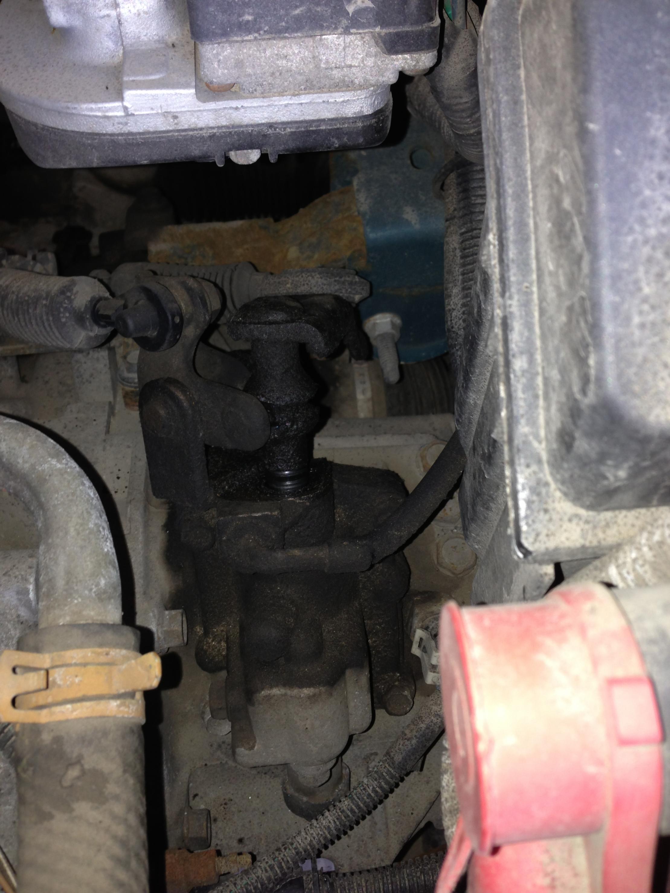

I do think the clutch must be getting quite worn out though. I have no problem with it going into any of the gears or reverse, but it seems like I have to let the clutch out basically all the way before it is catching. I have had an '03 & an '05 Cavalier and neither of them seem to have as much travel in the clutch. I did top up the clutch fluid as it was a bit low, which I'm guessing means it must be time for a new one...

Regarding your problem. There are two possible reasons for this. Air in hydraulics or bad clutch spring - I mean the spring in clutch assembly.

I took the car in today and i have a clutch kit on order (pressure disc, clutch, slave, throw out bearing), the brand is LUK. My dad is going to install it with me. Thanks for your possible reasons for my problem.
