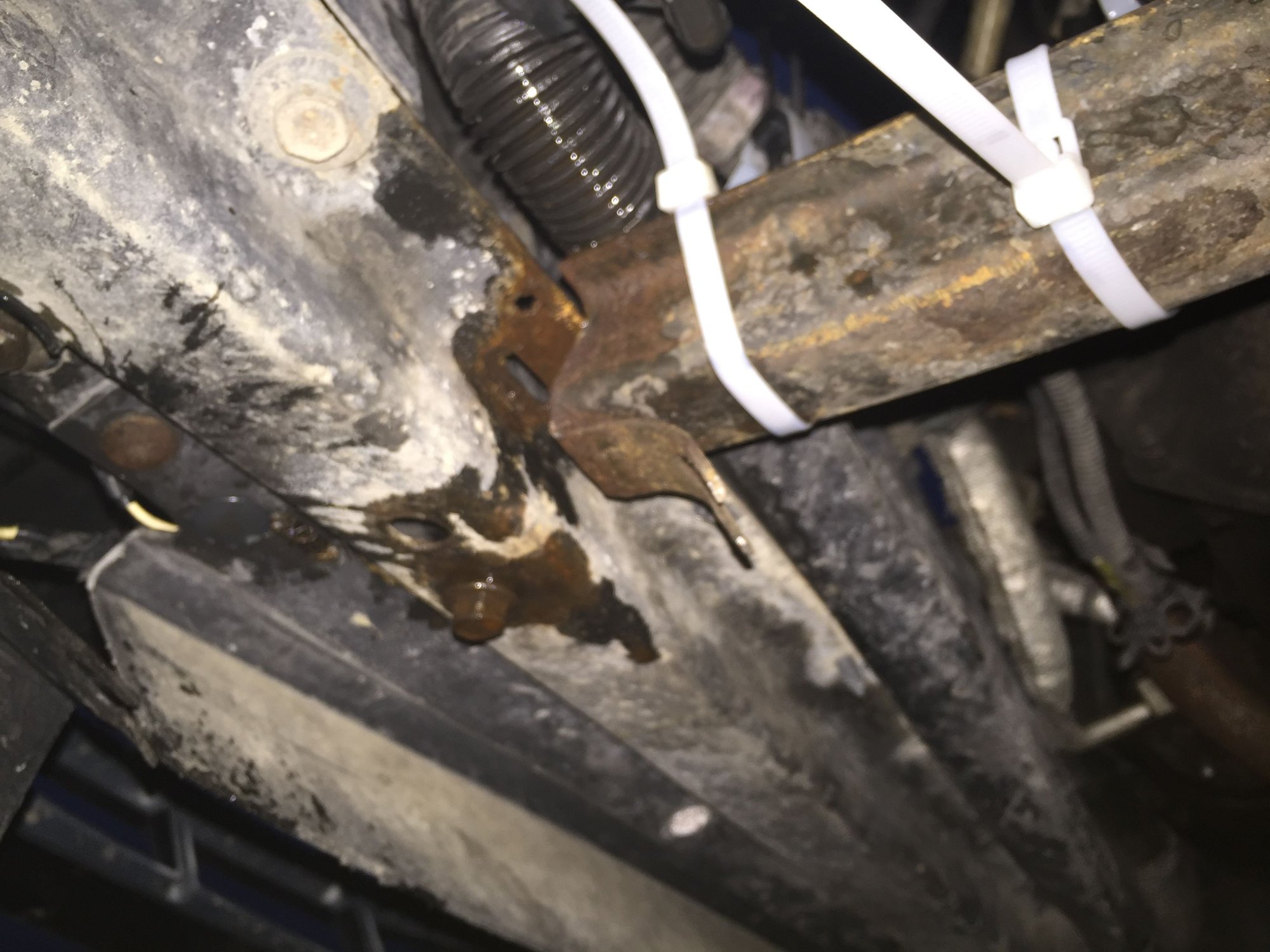

I uploaded pictures of everything I can see. I currently have about 15 industrial zip ties holding it in place but in hoping to find a sturdier fix as I have to travel 120+ miles this weekend for military training, and don't have time to get a permanent fix until tuesday. Need help ASAP. Thank you.
View from the top of all the zip ties holding it in place.
View of the bar.
Full view of bar.
View of the front of the bar.

the bar bolts to the subframe at either end, iirc, the rad support on one end and near the eng/trans mount on the other. the last picture shows the bolt for one end. hammer the bent tab straight and bolt it up.
time for a new flex pipe
