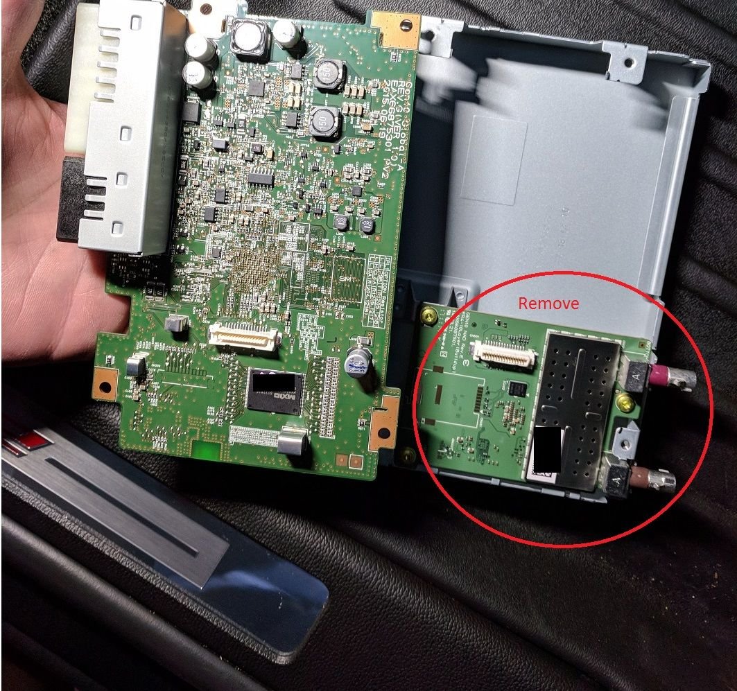

The last few years the onstar module was behind the infotainment screen, in the 2018 it was relocated to under the passengers seat, far right, behind the bose module. Here's my process for removing the antenna circuit board, which disables onstar by disabling the cellular modem and the wifi hotspot. Afterwards the Bluetooth works, the Nav still works, the mic still works for commands. What will Not work is onstar, wifi, the cellular modem (used for wifi and onstar), and the compass. The Nav shows GPS with a crossout but the nav still works, including traffic (that’s from the satellite data)

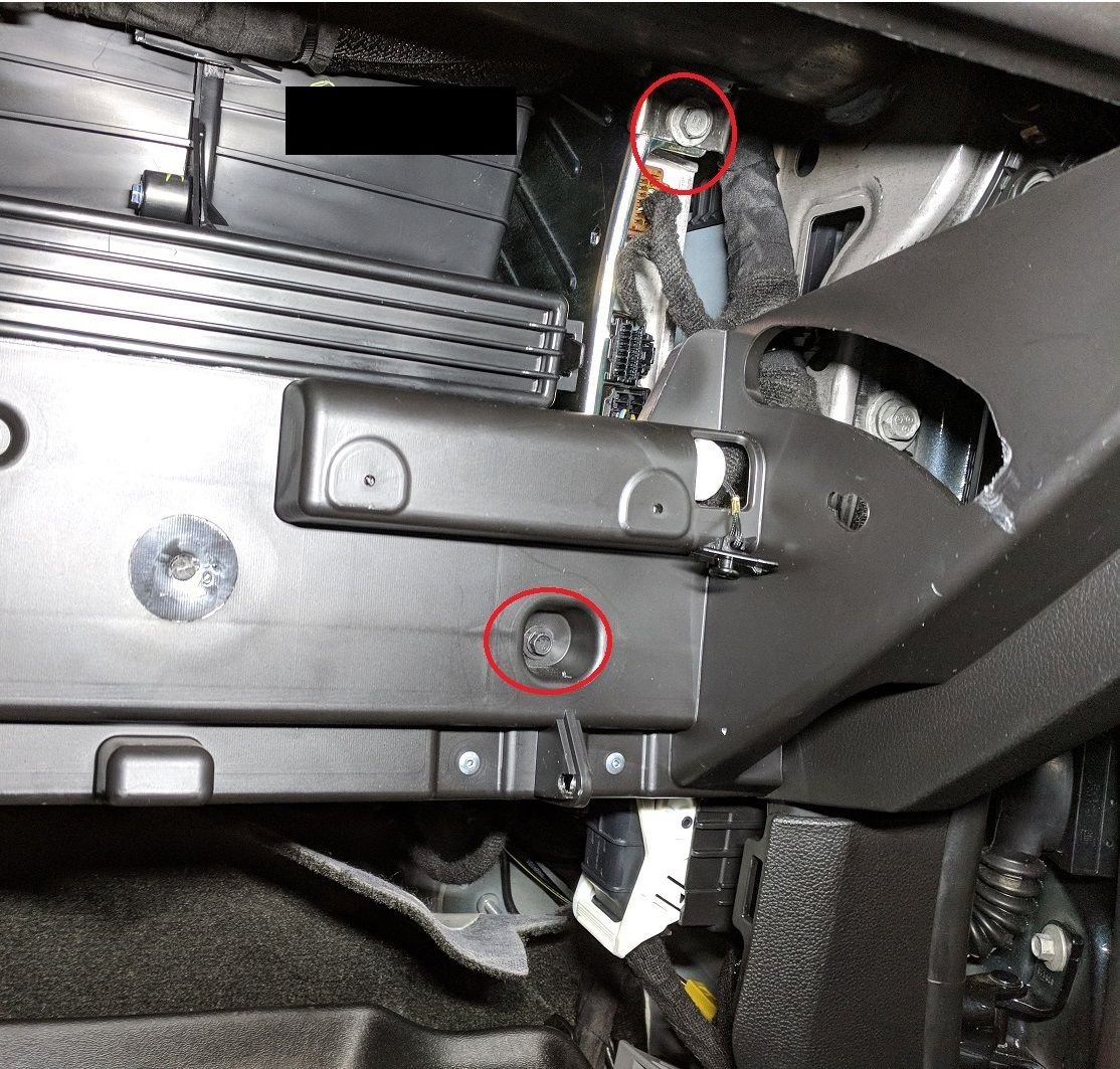

Step4. Remove the Bose box. There are 2 screws and 1 bolt to be removed to free the bracket holding the bose box. Once free reach through the top hole and remove the cables. the tabs are on the right side, there are 4 and the 3rd down has a red catch you'll have to pull towards you first. Once those cables are free work/slide the unit out the bottom. The cables should be able to move out of the way now to facilitate this.

Step 6. Open this box and remove the top board to access the smaller antenna board. Remove the smaller board and put the larger back in.
Step 7, reassemble in reverse order!
